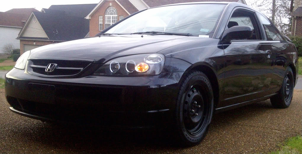

my rear fender gap was always smaller than fronts:
curious enough, when i finally corrected the rear camber (as in, more positive - I had to do after the lowering, rears were -1.6, fronts 0....), the gap improved (as in, the rear raised) - must be the geometry tha does it.
note that the car is parked in a slope, rear on the lower side, so it should be compressing slightly more.
i recommend using a rear camber kit and reducing the rear camber. getting a front camber bolt and increasing the front camber should also help.
and yeah, the wheels are still in the garage, but i am liking the black-on-black of the stockie steel wheels :P

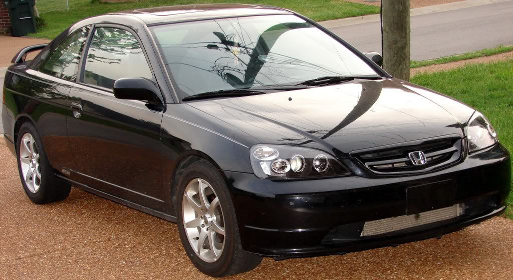

Here are some more pictures
FRONT
