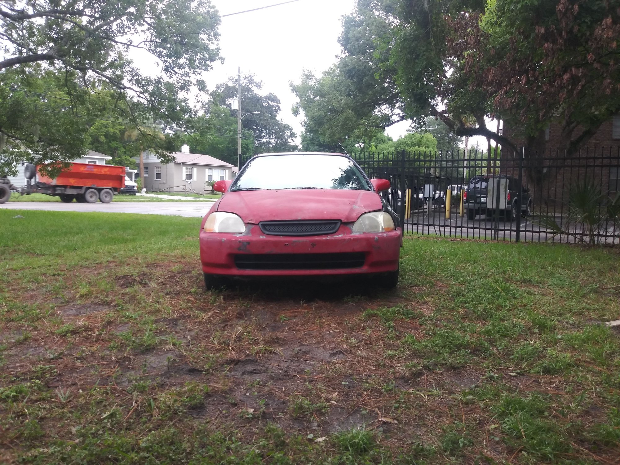

First look at car before buying it.

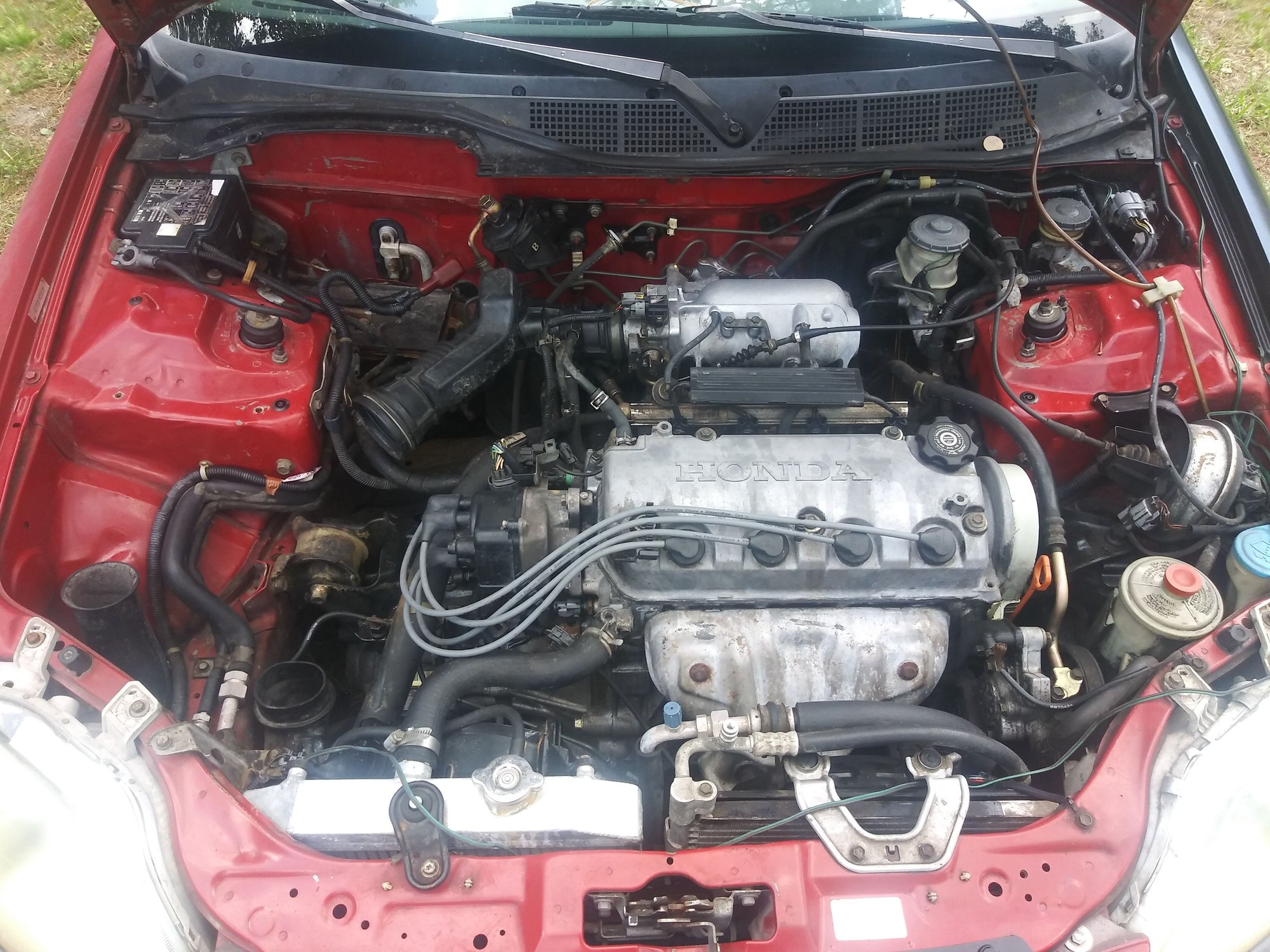

Trying to keep things clean. Everything was black when I got it.
