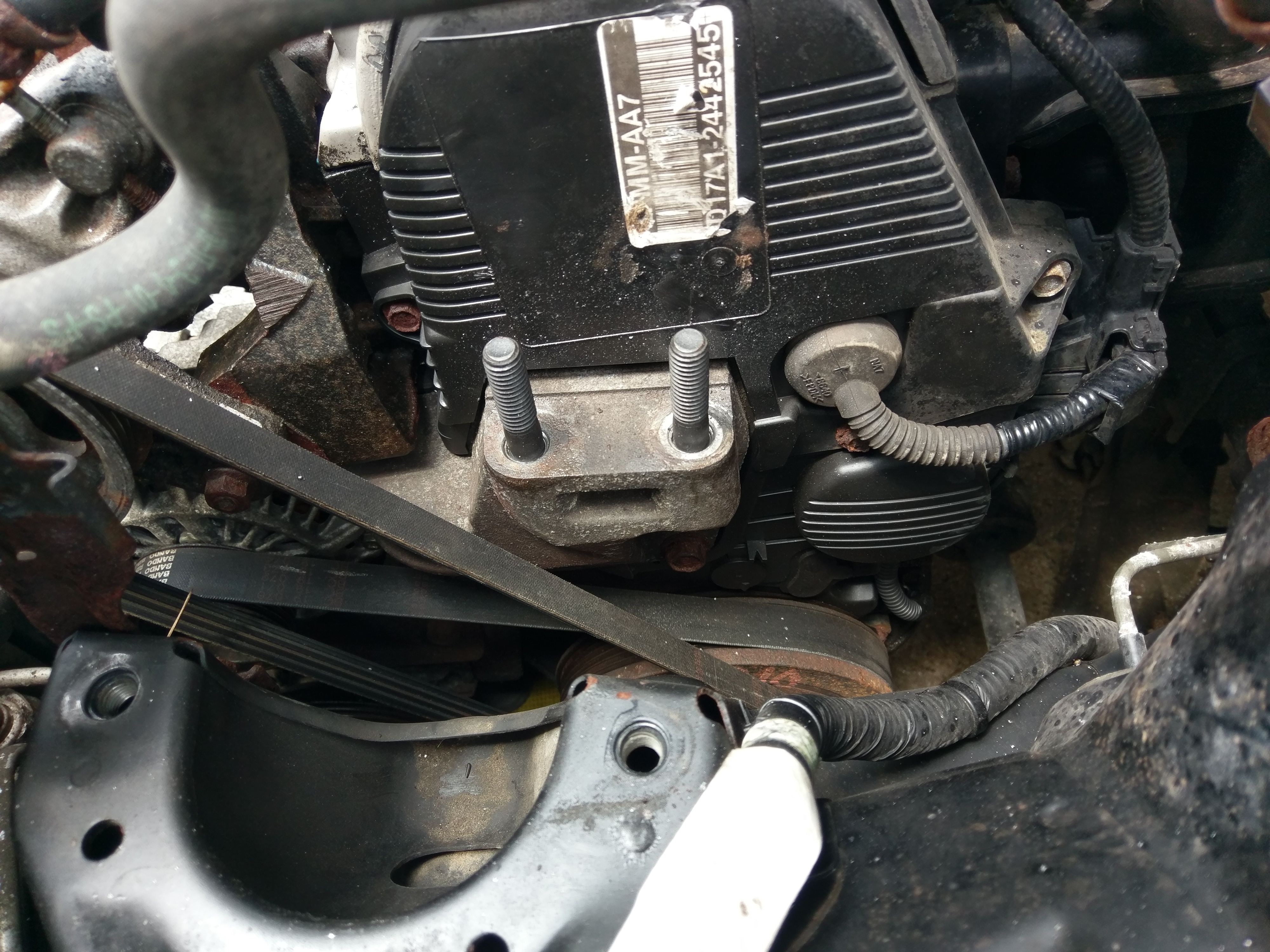

All fixed. Discovered the hogged out holes were almost the exact size that a 7/16 Helicoil needed to be. So I cleaned the holes up, inserted a Helicoil and got some hardened studs from Ace Hardware with flextop locking nuts. Some red locktight for good measure and its good as new. Upon starting the engine it was immediately MUCH smoother then anytime since I've had the car leading me to believe along with the witness marks on the mount that the front stud hole had been stripped for awhile and the rear one finally let loose.

Lol, nice fix. My studs were threaded throughout the length of the stud and are a slightly larger diameter than OEM. I don't even think I used any loctite and it's held nicely.
Good job
