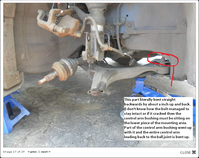

Hi all so I am going to replace my lower control arms in a few days and I have been spraying all the bolts to loosen them up. When I checked my right lower control arm I found out that one of the mounting areas is like a inch or so deformed (bent up and backwards) on the top where the nut goes onto the bolt(I think). Would I have any trouble deforming this back into place with a good pair of vice grip pliers and maybe a few swings of a mallet/hammer? The weird part is that the bushing sort of deformed with it so I think I might be fine since the mounting point didn't take all the damage.
I didn't take a picture when I had the wheel off but I circled the area that I am talking about(This picture is not of my control arm).

You should be able to form it back but every time you bend metal you weaken it so it depends how bad you have to bend it to get it back.
No, it will not come with new bolts. Maybe some aftermarket ones will.

Just get it out of there and get new bolts.
Honda bolt....
Part No. 90118-S5A-000
about 5$ each. get them from anywhere on the net.
