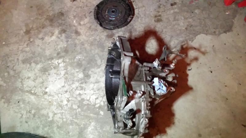

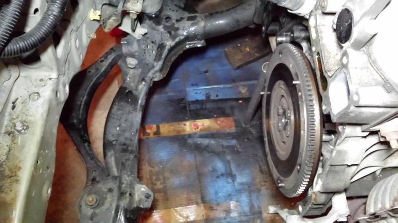

I managed to pull the transmission out from the top today. I've posted some pictures. It was very easy. I had a helper for the physical lifting part and we had it lifted out in less than a minute.
The thermostat housing and pressure plate had to be removed first. Pretty easy to do both. The fly wheel and sub-frame stayed in place.
Removing the transmission first made it much easier to get access to the fly wheel bolts and I was able to zip them off with my impact driver in no time (The flywheel is getting re-surfaced).
