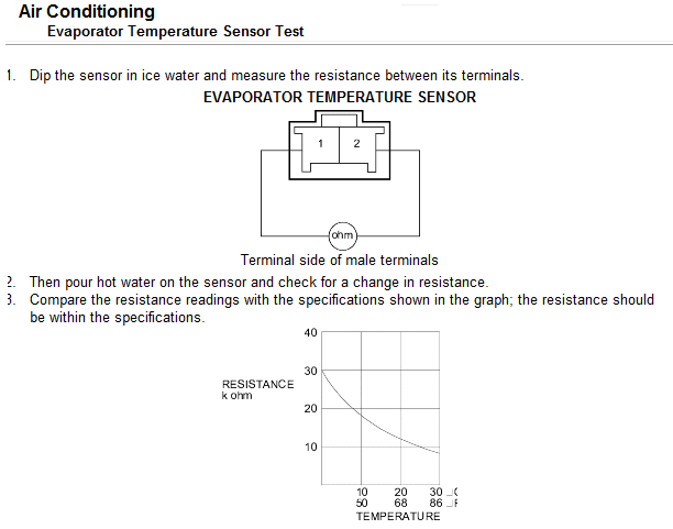

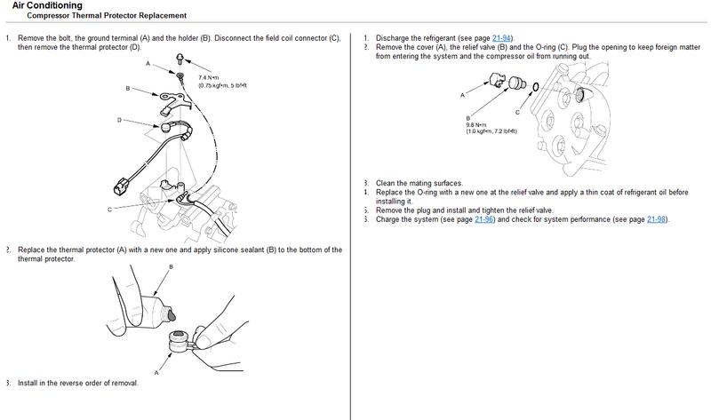

Here's some photos from the FSM to help. Attached are four pics. And yes, the FSM does have troubleshooting and replacement for both parts.
Pic #1, thermal_prot_chk.png, How to check the Thermal Protector.
Pic #2, thermal_prot_repl.png, How to replace the Thermal Protector.
Pic #3, evap_sensor_chk.png, How to check the Evaporator Temperature Sensor.
Pic #4, evap_sensor_repl.png, How to replace the Evaporator Temperature Sensor.
Hope this helps!

Re: A/C ISSUE please HELP!
Great! Source . thanks! ill give it try myself..

No problem!
I think you should feel free to test the thermal protector... but replacing it is going to be a pain in the *** if it's bad (Cause you need to evacuate the refrigerant, and before you can recharge it you need to pull a vacuum, so you're going to need a set of manifold gauges and a vacuum pump... if you don't have the equipment, you can prob have a local shop evacuate the old refrigerant, then you go do the repair, and then have them recharge it afterwards).

So does the system need to be discharged to change the thermal protector?
Yes< if you look at the second picture from the manual, it says to evacuate the system before changing the thermal protector.
Thanks,I did see it after posting.
The manual image seems to have directions a bit *** backwards there,telling to remove it,blah blah bl;ah,before it tells to discharge the system.
No it does not... If you can reach it to replace it.
If you have to remove the compressor and open up lines to reach it, then it would need discharged. I think most can be reached without having to do that much work though.

Question Re: A/C ISSUE please HELP!
Thanks for your input.
That was easy enough,BUT...
I see the top of the sensor either has a coating or it should be metal and has built up sludge that needs removal. I'm thinking it needs to be clear metal for good contact with ground plate. It's awesome too that the system didn't need discharge,but man,what a crappy setup. If I can't get this to make it right,I'm going to look at the switch on the A/C panel. This thing has proper freon,pressure,everything looks good except it only gets cool in cloudy or cool weather and the sensor itself checked good,continuity when just sitting there. One I pulled appeared that the person had filed the top of the surface and had good clean contact. That's what I'm trying to do,but it almost feels rubbery. I really do not think it is rubber as I mentioned. Clean metal contact. BTW,I'm in FL. No A/C is unacceptable. It's frikkin torture. Maybe I need to look elsewhere since it does get cooler than it is now. I also have changed out ECM (for something unrelated) and evap thermostat. No change.
Thanks again.

The thermal protector is usually glued into the hole with Silicone (RTV), that's the rubbery stuff you feel.
If it's got continuity it's probably good, unless it goes open circuit when hot and causes the compressor clutch to disengage.
What happens when the AC doesn't get cold----Is the compressor no longer engaged at that time?
Check air gap of the clutch plate.
