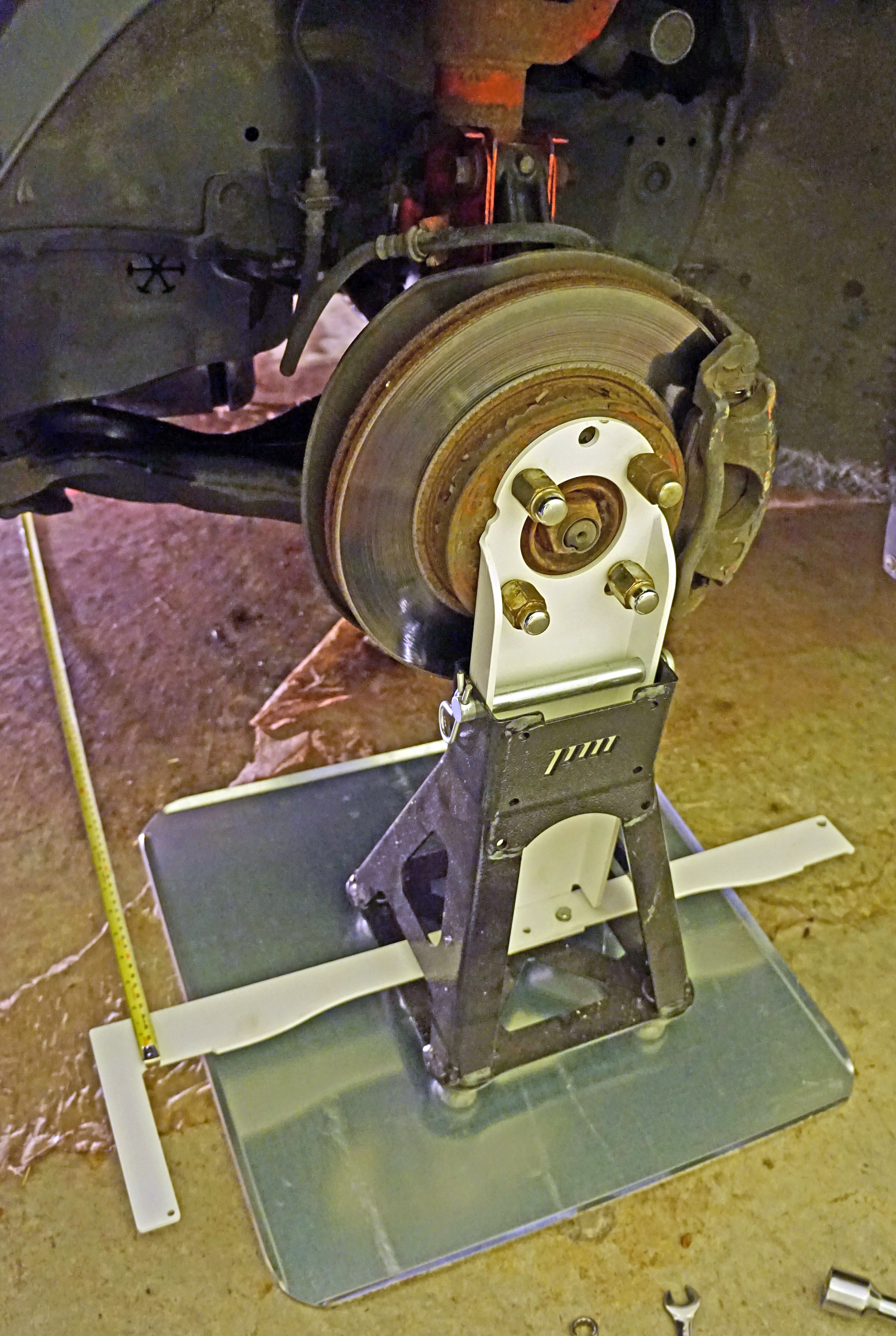

yeah, the stands for DIY alignment are quite expensive. I only own because I have 4 cars, so saves me in the long run.
some make do with some metal sheet with grease sandwiched. Stands are Flyin'Miata, I own two miatas (lower than the civics)
