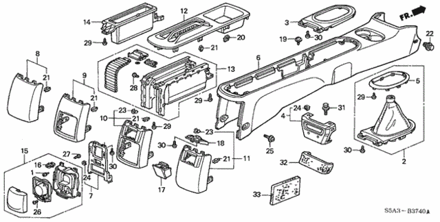

I am having the hardest time finding a tutorial on how to get access to the bulb in the gear shifter indicator on the center console. Youtube has lots of videos of 03-04, which have a different plastic trim that allows for easy access, but on the 02, the entire center console appears to be one piece and I am not sure how to remove to swap the bulb. HELP!

just remove the center console, bunch of phillips screws. light bulb should be a quarter turn socket in the plastic showing the gears

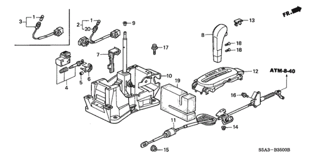

I hope this helps. Exploded view of where the screws and tabs are. Bulb is #1 on the second picture.
