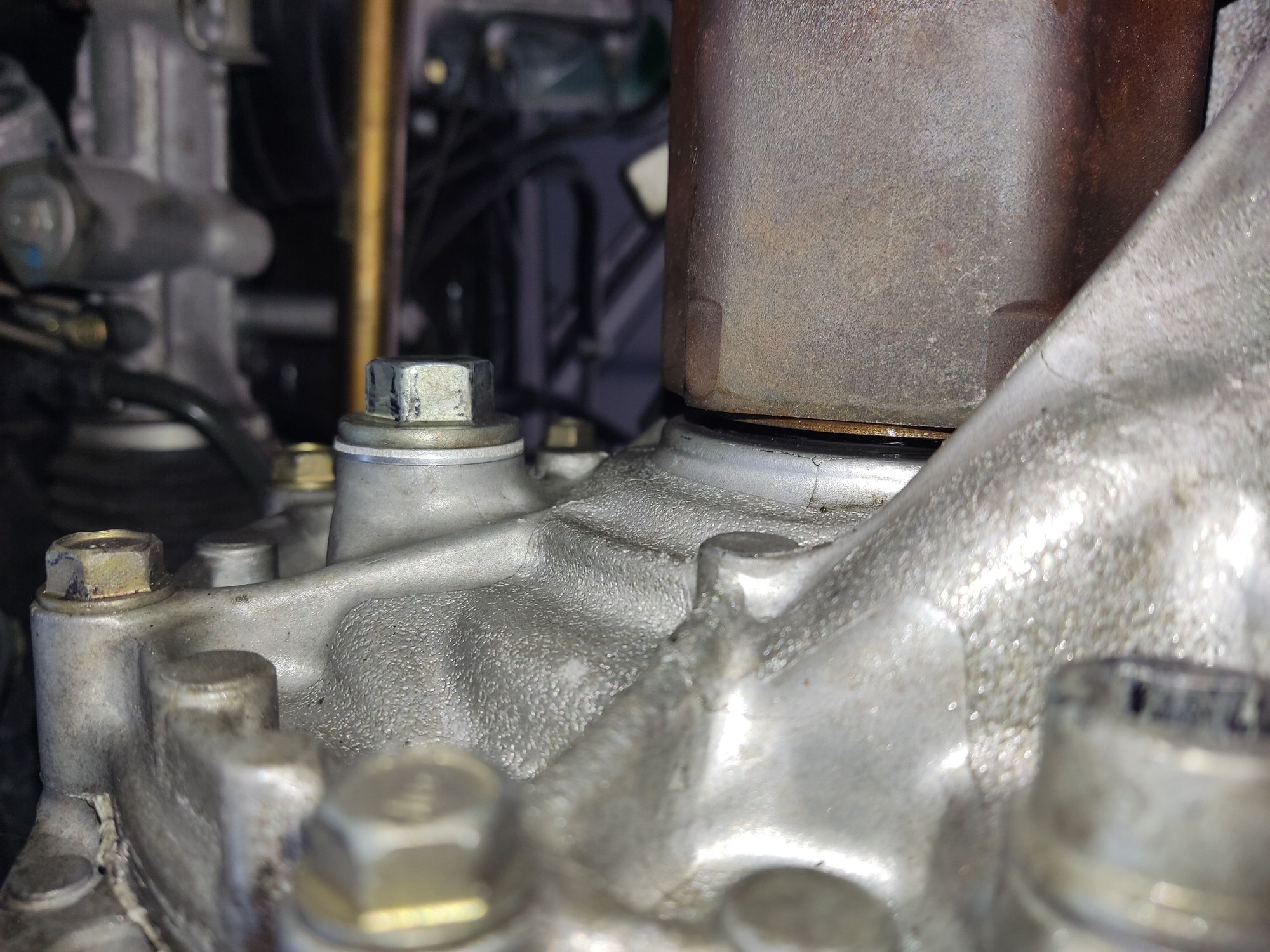

Hi there so I finished replacing the clutch in my car and it has leaked a fair amount of transmission fluid from somewhere around the fill bolt / right side axle port, I called my mechanic mate and he said it should be okay to drive home so I did, I'll be able to tell how much it leaked when I fill it up with a spare ~450ml of fluid, depending on how much leaked out will that determine if anything was damaged? Here are the pictures of the right side axle into the transmission (I cleaned the fluid off)if it isn't in far enough how would I go about fixing it, when I installed it I gave it a good push to get it in, also worth saying it went a few days and maybe 30km without leaking. Also if I do have to take the axle out and re seat, can I reuse my axle nuts? I've already re used them so they've been staked twice, should I just replace them?
Old Jan 21, 2022
Wankenstein's Avatar
Joined: May 2012
Posts: 3,634
Likes: 109
Rep Power: 211
Re: Axle improperly seated?
You should hear a click noise when the axle is fully inserted into the differential. Best to grease the a inner axle splines a bit and bang the outer axle with a rubber mallet until you hear the click sound.
Per the pic it looks to be seated well, but best to be sure via click noise
Most likely it's the rubber differential/inner axle seal that is torn or worn and causing the leak.

So after filling the transmission back up, I lost around 150-200ml of transmission fluid, so I can't imagine that would cause major damage over a short distance?

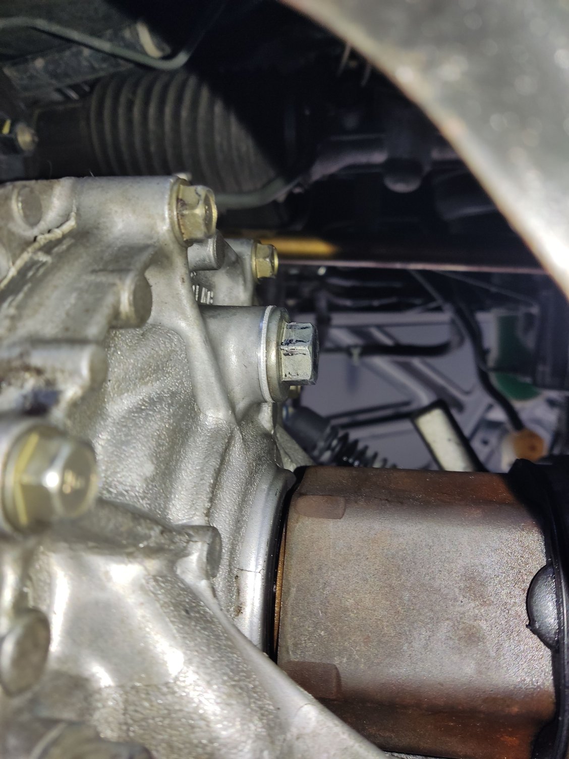

Compared to the other axle it is sticking out further? And just then on the jack stands I brought the car up to around 60mph for a minute or 2 and sure enough there was a small puddle of fluid on the ground again, and I really looks like it's coming from that axle, what should I do?

remove and push it in again. I am not sure you should have made the ring smaller, though...
you had not had a leak until now because you did not have enough fluid inside.

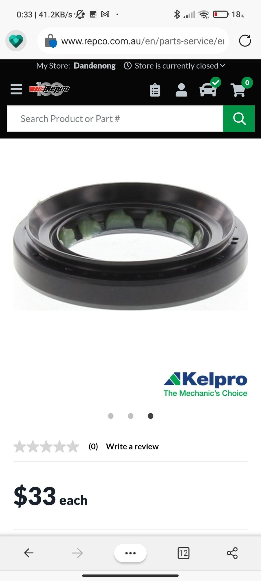

So I managed to get the axles and seals out no worries, however the seals Im going to buy look like they are pre greased, so in this case should i just rub some MTF onto the splines instead of new grease as I've heard mixing the wrong greases will cause them to break down?
In bold I think you meant to say axles instead of seals.
If there is grease already on the splines then just keep that grease in place and do not add additional grease. Remember to listen for the click sound to be sure the axle is fully seated.
If the output shaft (axle/differential) seal is round tap it in place with an appropriate size socket (ex: 21mm, 32mm, etc..) and mallot. Try to find some YouTube videos that demonstrate this.

I actually did mean the seals although I might have been wrong, I thought the green stuff in there was grease, and I'm not replacing my axles as they seem fine to me, also I noticed that on the left side axle port there are some sharp burs around where the seal sits, thankfully they are pointing outwards and don't affect the machined surface, but I thought that was interesting. I tried to get a photo but I couldn't get it to focus with the flashlight

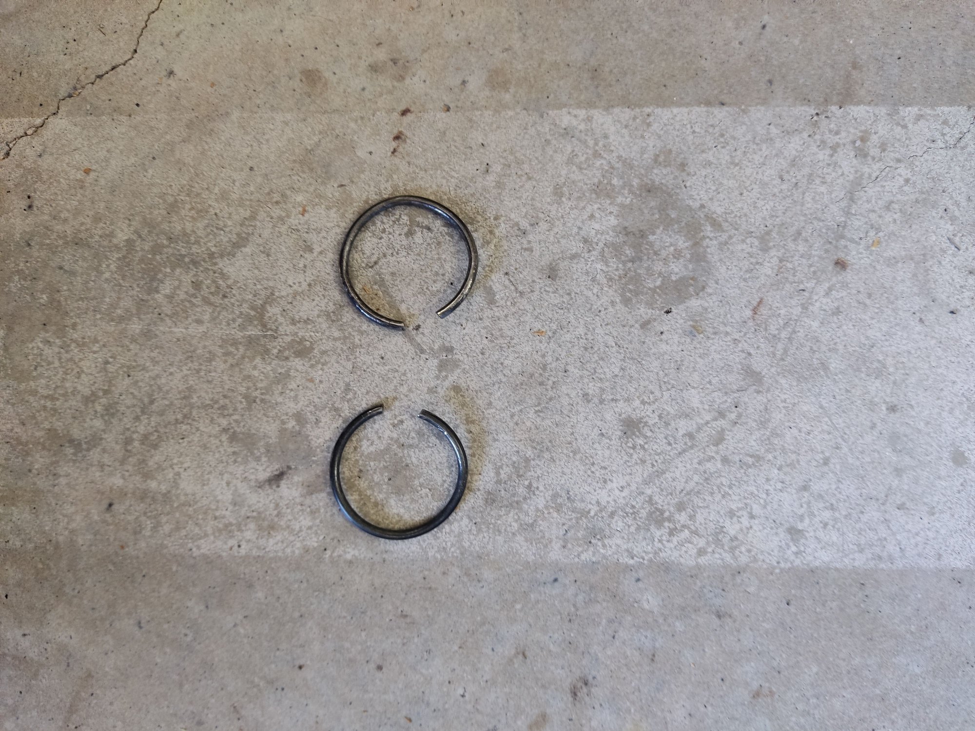

Also here are the retaining rings that I'm hesitant to reuse
Those rings look a little bent, but they should work.Try to straighten the ring tips to align with each other if you can.
