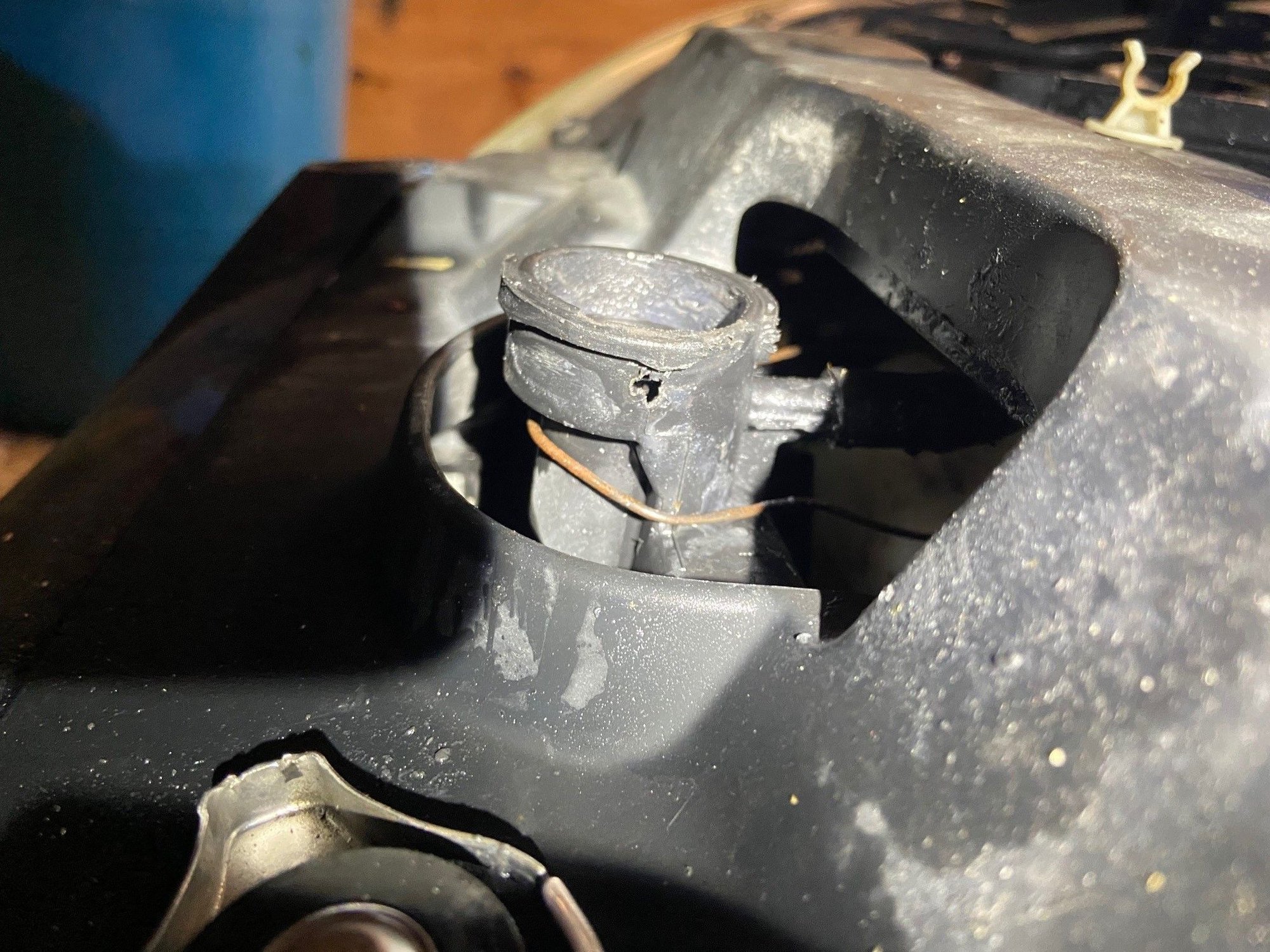

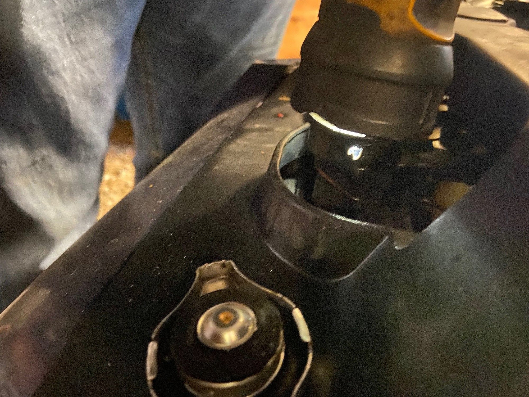

So, I have read through all of the thread and don't see exactly what our car is doing. It looks like I have a few tests to run to decide what the exact issue might be. We have a 2005 Civic LX 140k. While we were driving the car hesitated a little and then started steaming out of a small hole in the radiator cap neck, then died. The hole is just below the flange out on the "neck" of the radiator just below the cap about the same height as the intake hole from the reservoir. Would not restart while it was warm, winched it up on trailer, let it set over night, it started right up and drove in our barn so I could dig deeper. Added maybe a cup in the reservoir, and 2 quarts in the radiator itself, it ran for 20 mins with the rad. cap off. No sign of bubbles in the rad, but steam starts coming out of the rad. after 20 mins, and heat went cool in the cab. Put he cap on real quick to check and see if it puked out of the reservoir, and it just "steamed" out of the side of the neck. Shut it off and the reservoir is at same level and radiator is a little low but i can see the coolant down in the neck. The temp gauge never leaves 1/2. We just purchased the car in November and have not put 2K miles on it, radiator looks newish and so does the cap. Let me know your thoughts, so I have a little direction to start. I will do the home carbon test to see what it says. TIA

Post a photo of this "hole" in the neck

Get a new rad. Denso is the oe supplier

Yeah, that shouldn't be there. As mentioned, new radiator. Make sure you fill and burp properly, then make sure there are no other issues.

OP...for future reference please post pertinent pics on your first post. I just wasted 10 minutes of my life on my previous (lengthy) reply, when I could have summed it up in "replace radiator".
