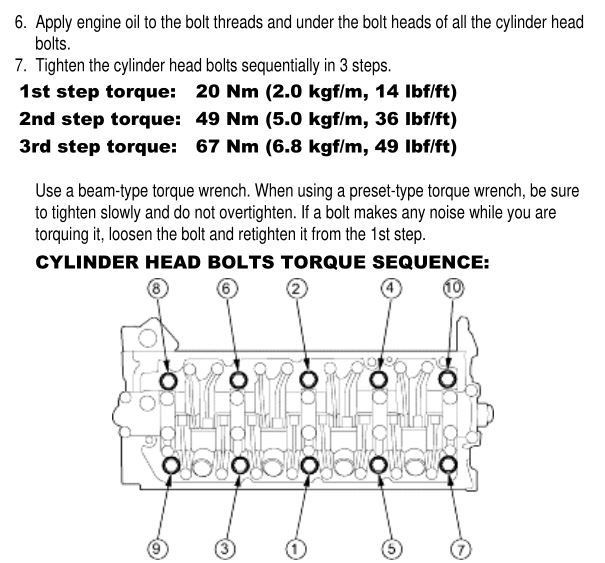

I've always torqued the head per my manual with my Snap-On digital torque wrench. I'm thinking about going to 75nm this time. Has anyone tried this?

Says in the instruction "don't overtighten" It's not worth the risk of stripping a bolt hole. The head and block expand (heat) at operating temp so if even if it a bolt hole didn't strip at 75nm when the engine is cold it may at operating temp?
Did you check the block for flatness?
Also, there is a wear indicator on the cylinder head that should not be milled past that indicator depth.
