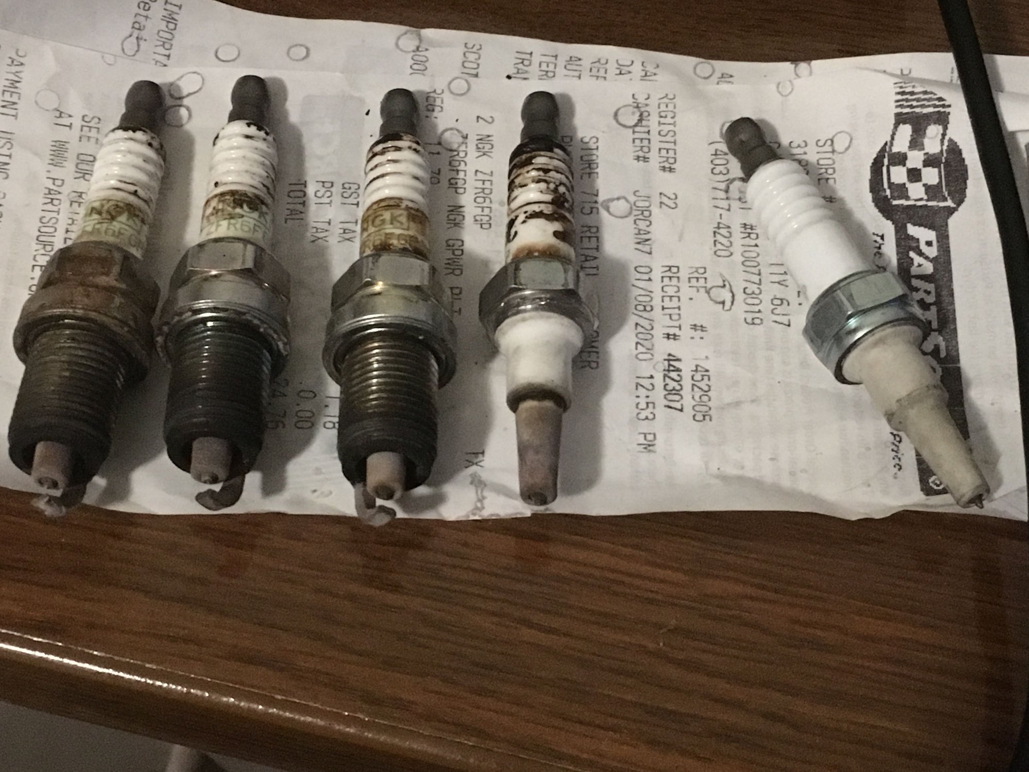

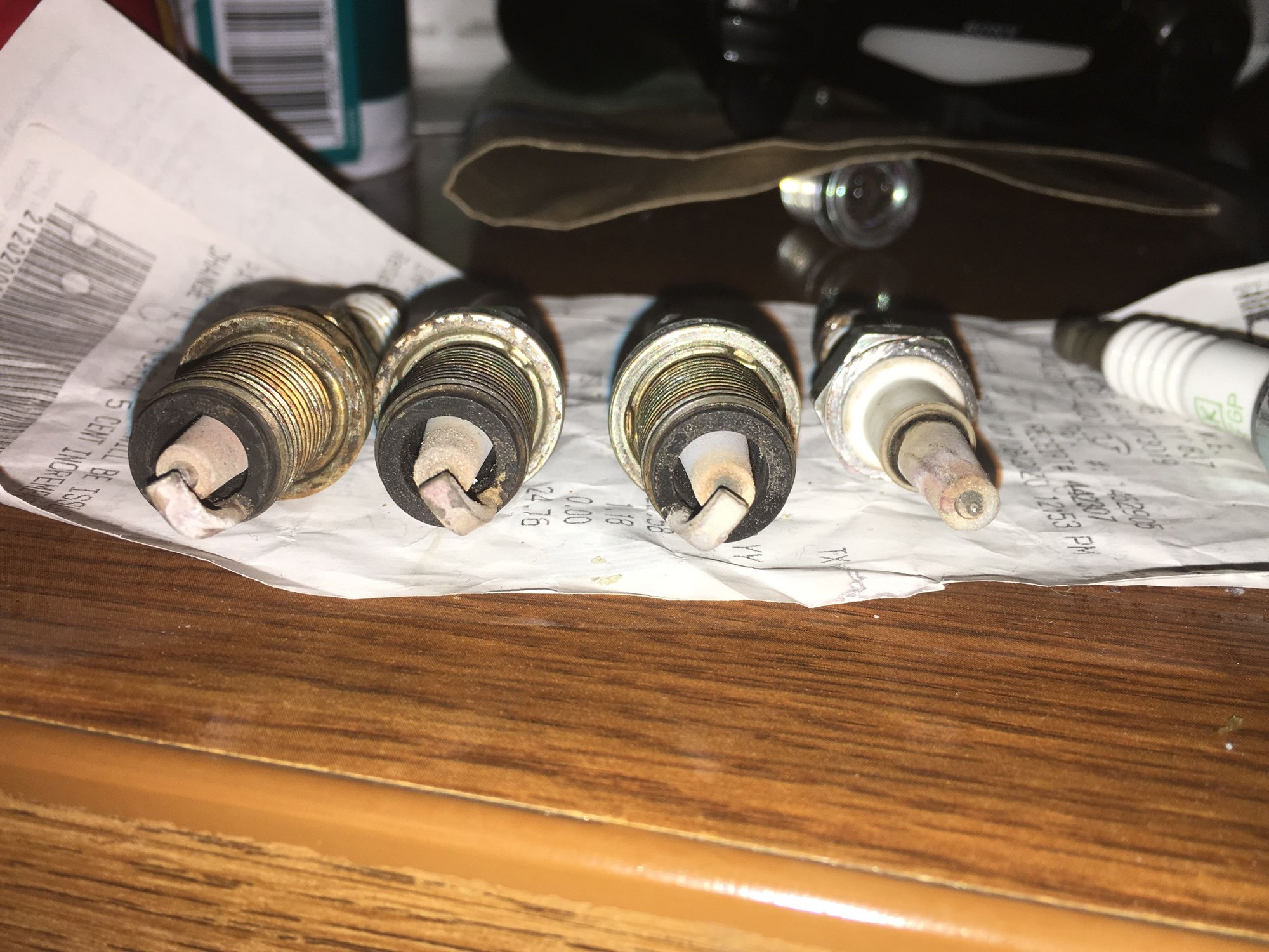

Here are pics of 4 (well, 4 and a half because a mechanic needed to break one's half to make a plug remover) old sparkplugs and one that was broken, if anyone is interested.
I tried to remove the 3 plugs to see how they looked after a month but they were SUPER tight so I will just leave them be... don't wanna repeat the same thing again.

Normally just leaving a old plug in is not the issue, but if you left a “bad” plug in it would possibly explain your observations.
Yea those spark gaps sure seem well beyond spec on the old plugs so I am guessing it was “bad”.
