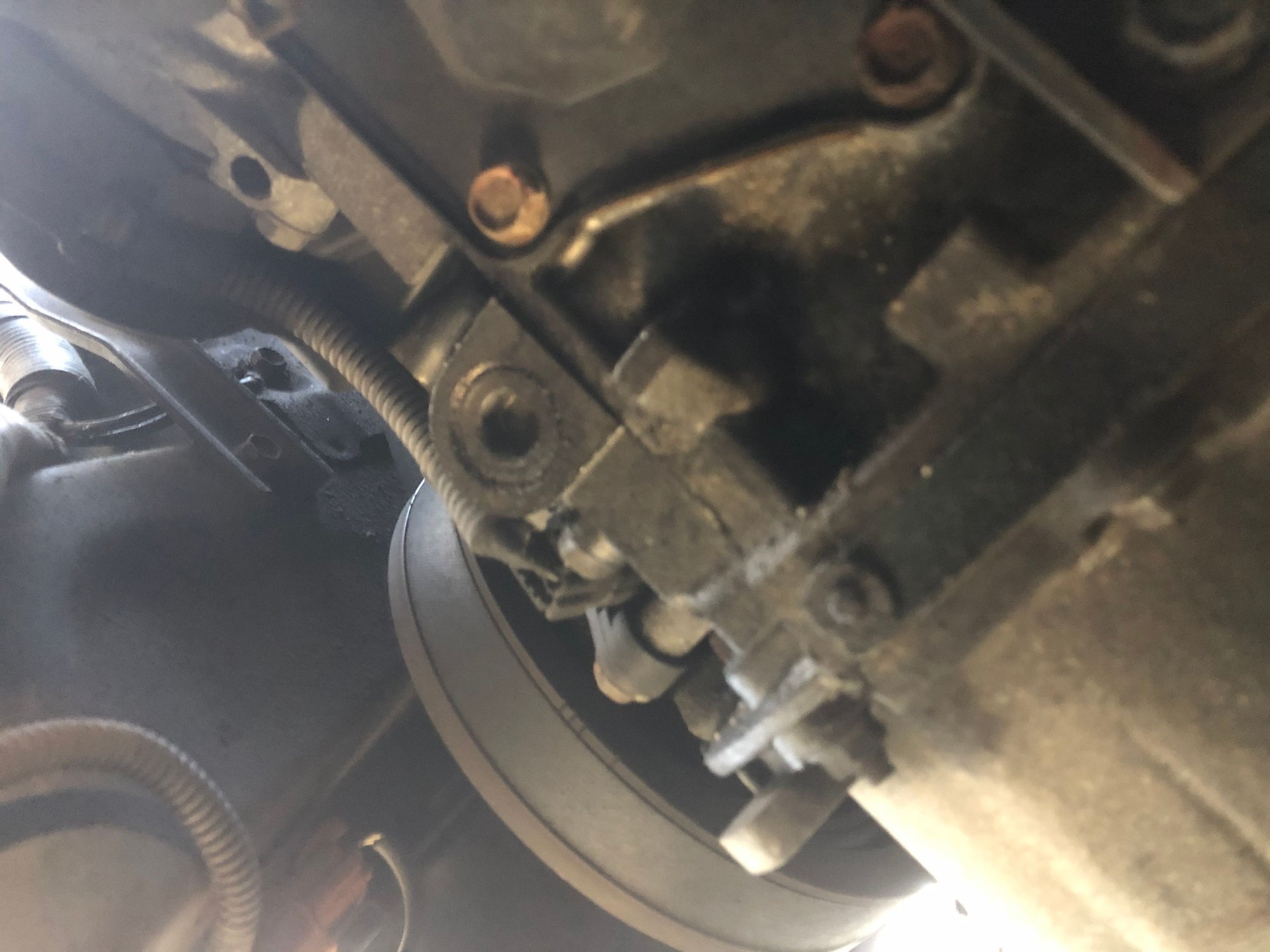

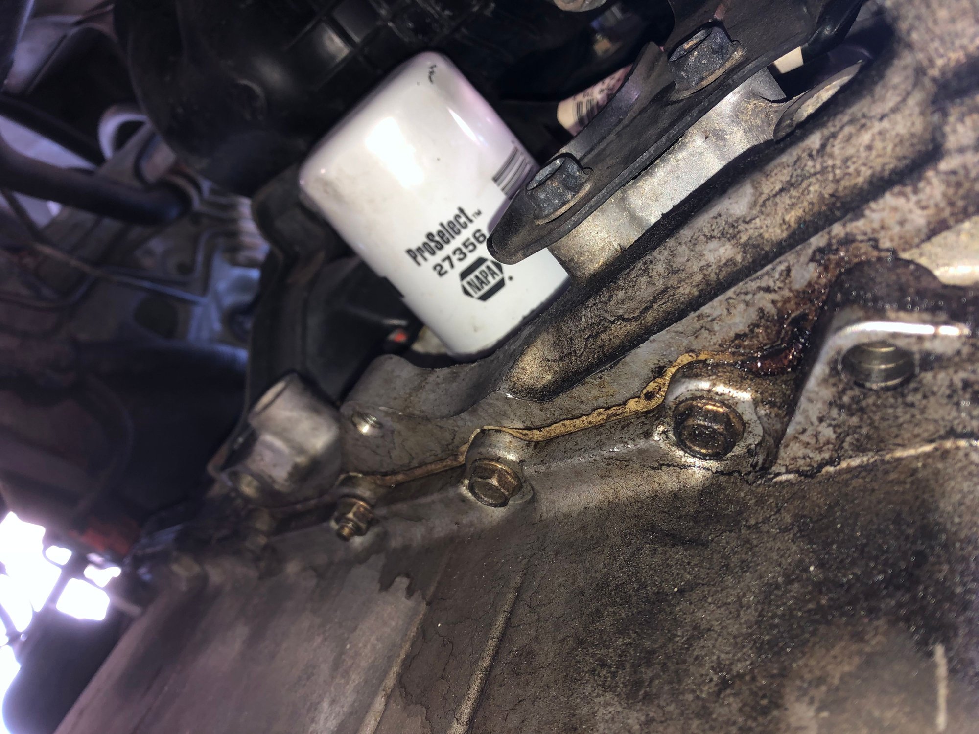

Hello Civicforum!
So while I am doin my tranny, I took some photos (attached below)of my oilpan, most of it are dry-clean but 2-3 corners on my pan showing trace of oil.Should I do the gasket replacement already for preventative measures?
Another question is should I use "red RTV "or just "gasket"alone? or both?
Kindly need advice on this, thanks in advice!

Judging by your pics, is it safe to assume you have an EX trim? If so, the oil pan gasket is just an RTV gasket

Your nowhere near needing to worry about that seepage.
If you do decide to reseal it anyways, use grey or hondabond and be prepared for the chance it will leak more than currently after the repair...

Kinda looks like much of the mess came from above the oil pan more than the pan itself.
Clean it thoroughly then evaluate again later on?

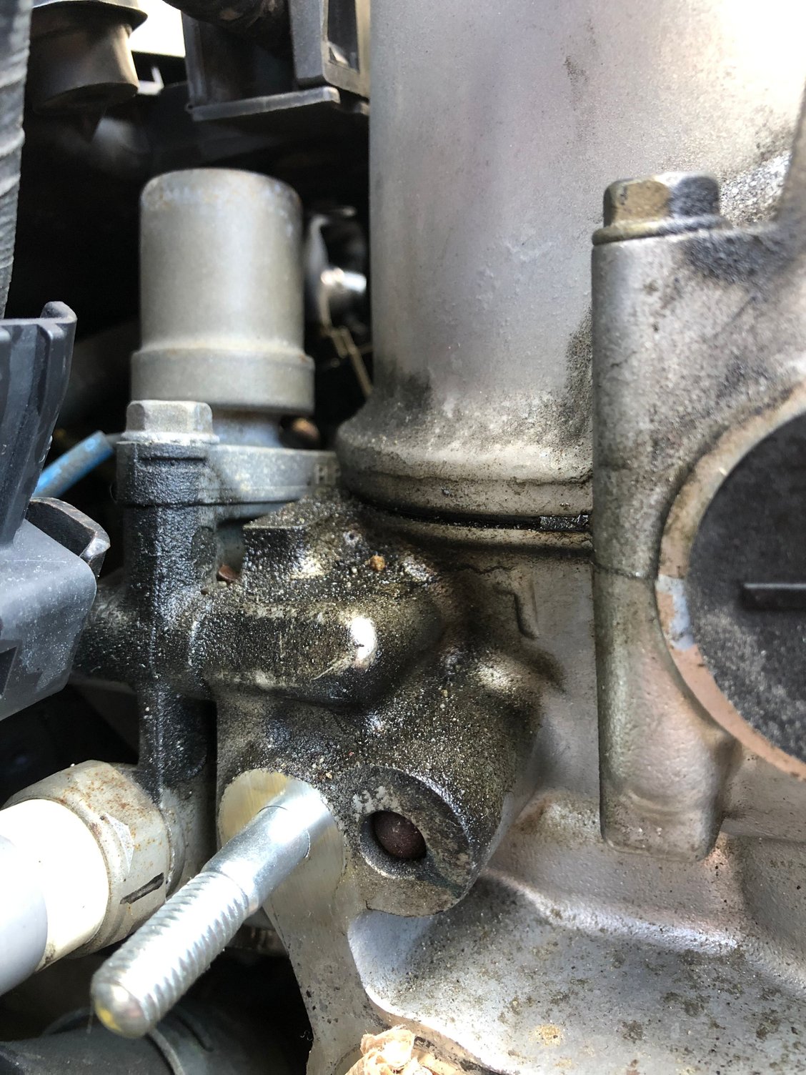

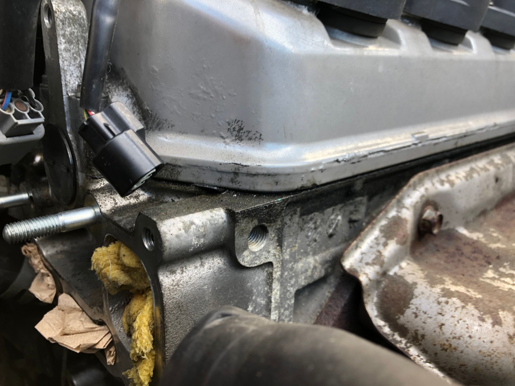

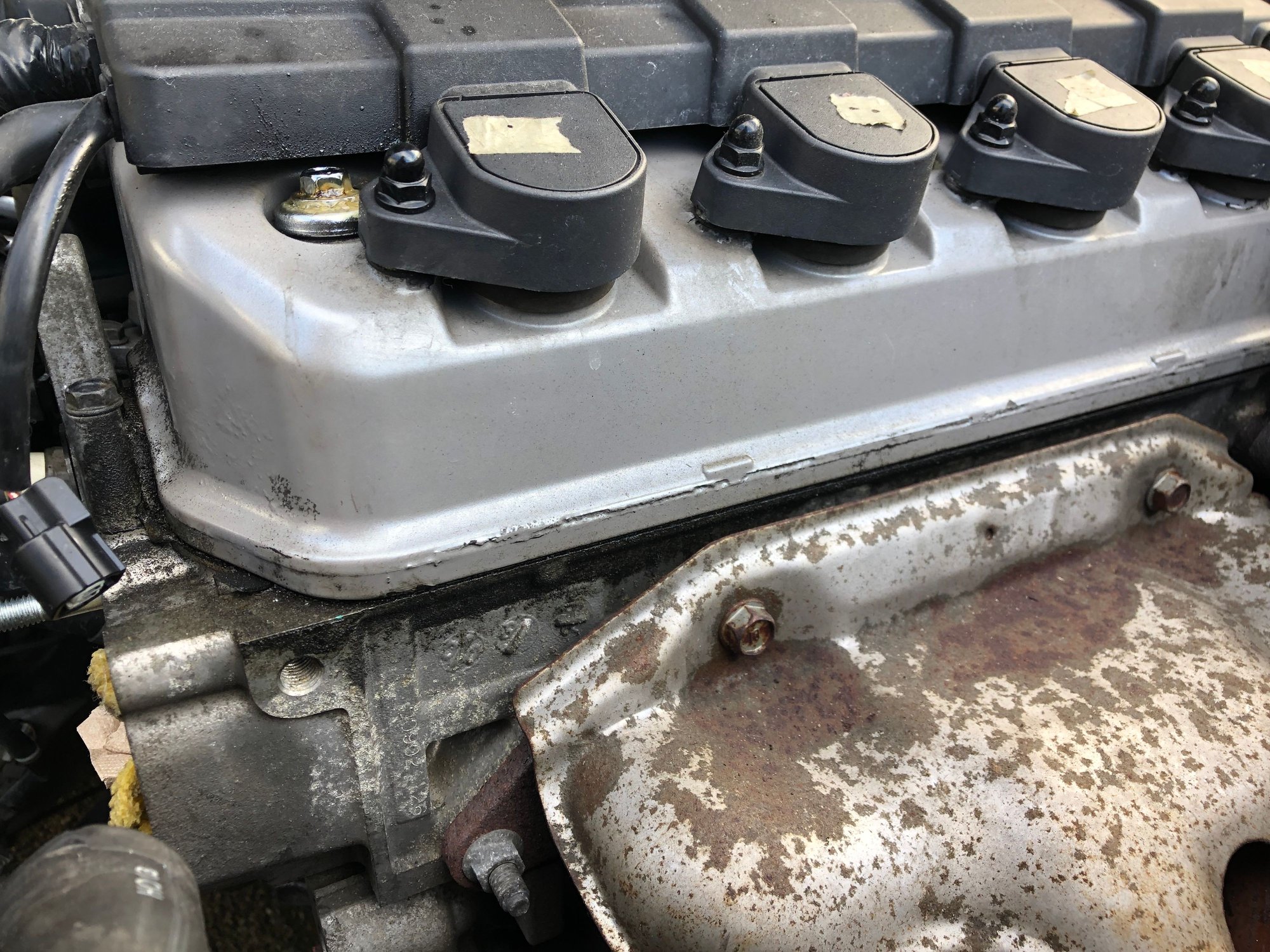

Hi civicforums!
So I took some photos from valve cover area...
might be this is the reason...
but thanks!
ELfred
Old Feb 9, 2019
Re: should I do my oil pan?
Typical ooze for maybe 120-150,000 miles?
Valve cover gasket/cam plug/VTEC gasket set?
Oh hey regarding my reply earlier consider (most of the time) when the oil filter gets replaced oil will spill all over the back of the engine.......that can leave a big mess if nobody cleans it up

Again, your showing pictures of almost 20 years of seepage.
You have not stated that even have had one drop of oil has made it to the ground and that’s why I say it’s not worth messing with.
Personaly I would spend the same effort to find all the rusty spots and spritz those with some more oil.
