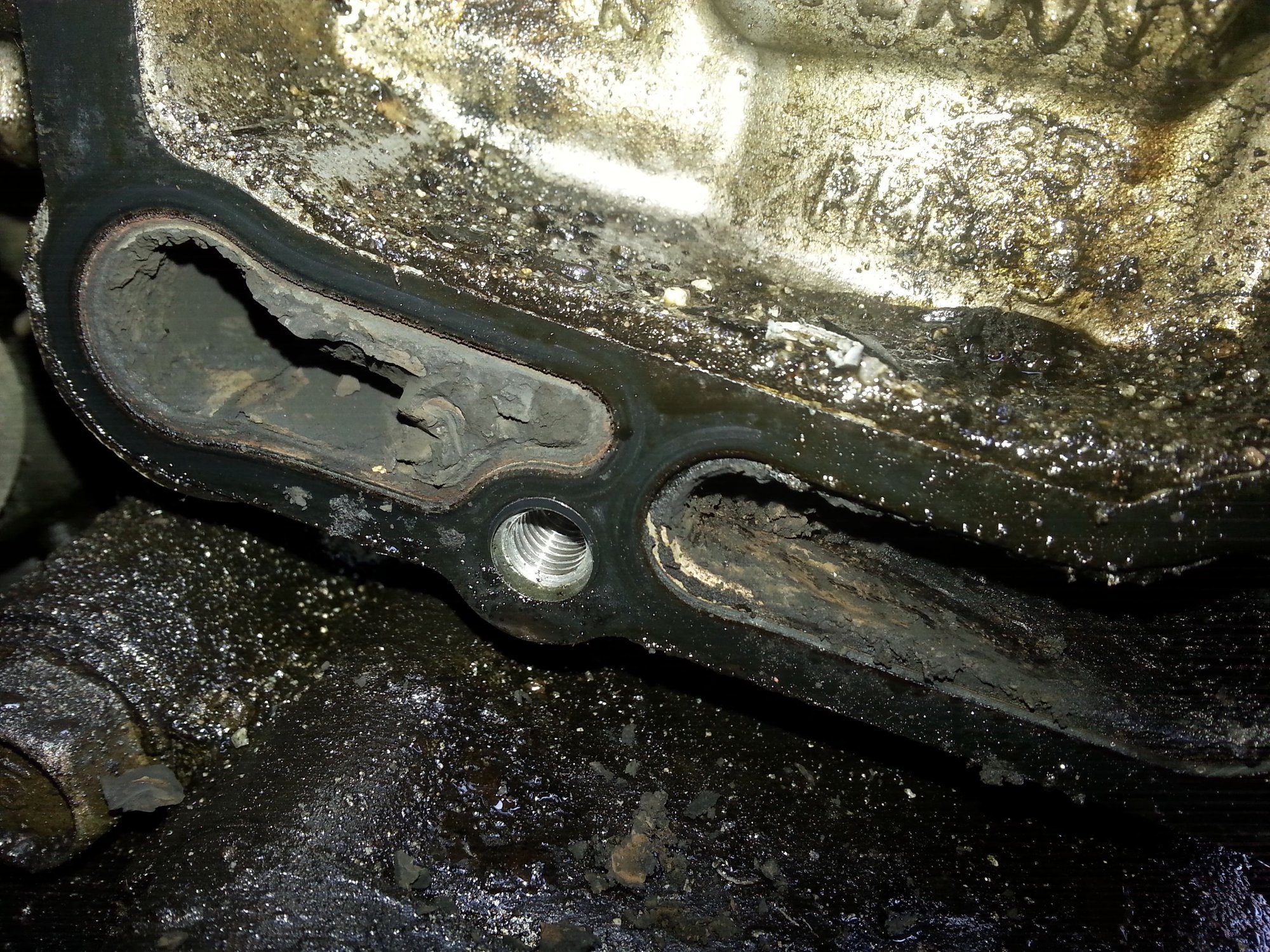

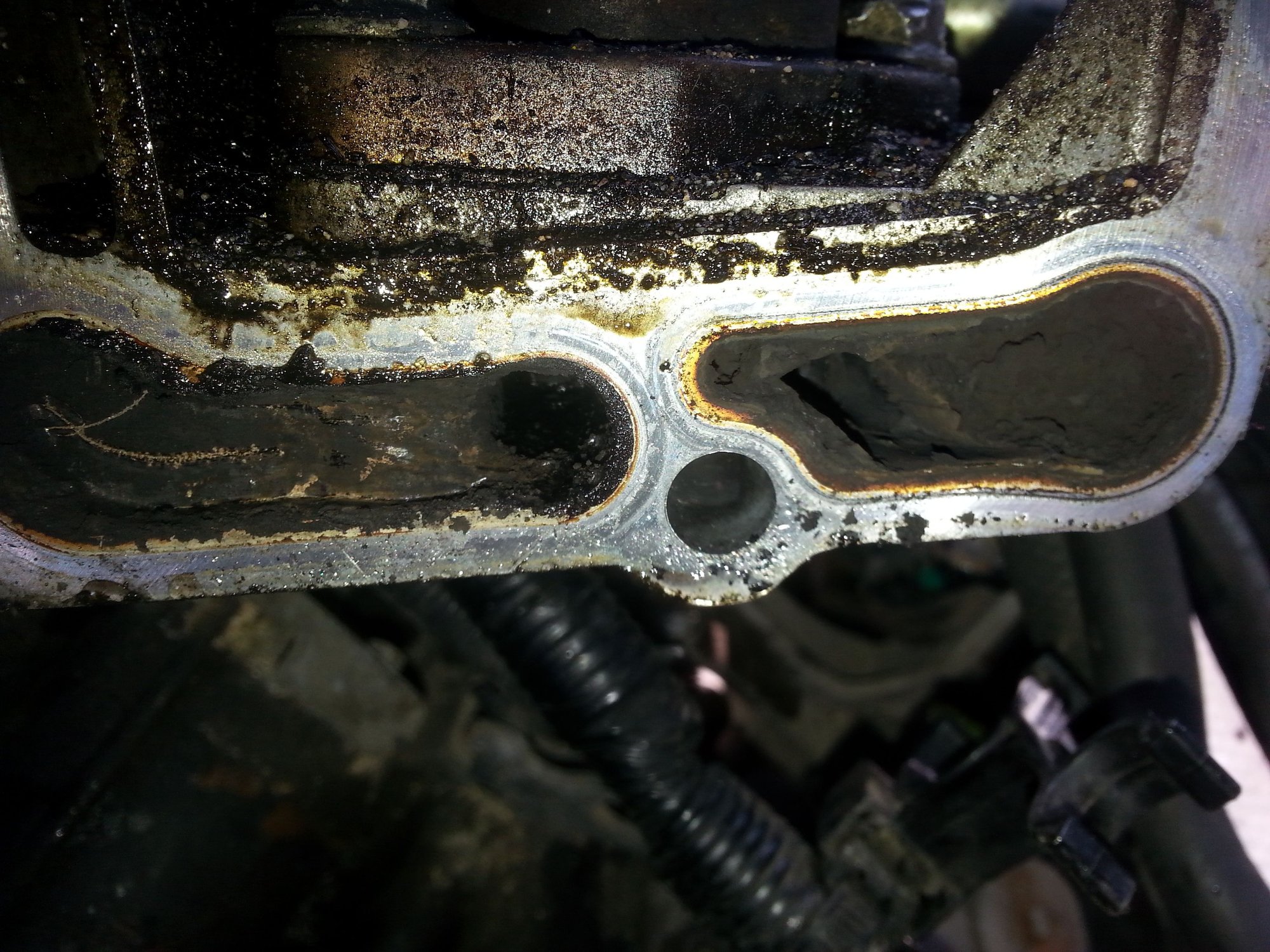

There's a couple more steps you could take to confirm prior to pulling the intake to get st those passages though.
Old Apr 9, 2018

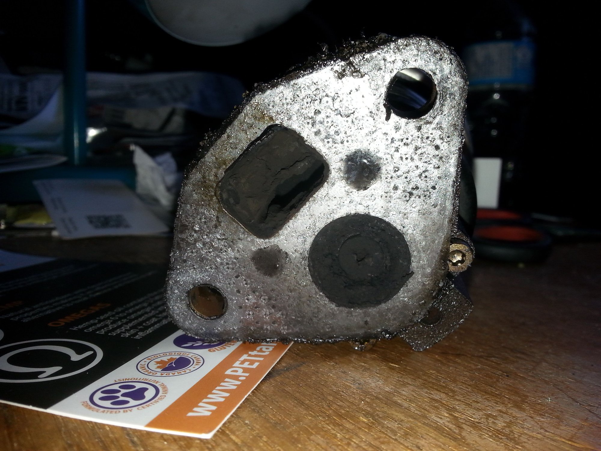

Im guessing this is my problem;

EGR valve Pintle looks like it's closed now.
If you connect its wiring right now Does the voltage reading reflect that?
You COULD cut a chunk of cereal box thin cardboard into the shape of the gasket (no holes for the passages though), place it under between the EGR valve and its mount to block the passages, bolt the valve on (just tight enough to cinch the cardboard so it doesn't leak) and see if your miss is gone

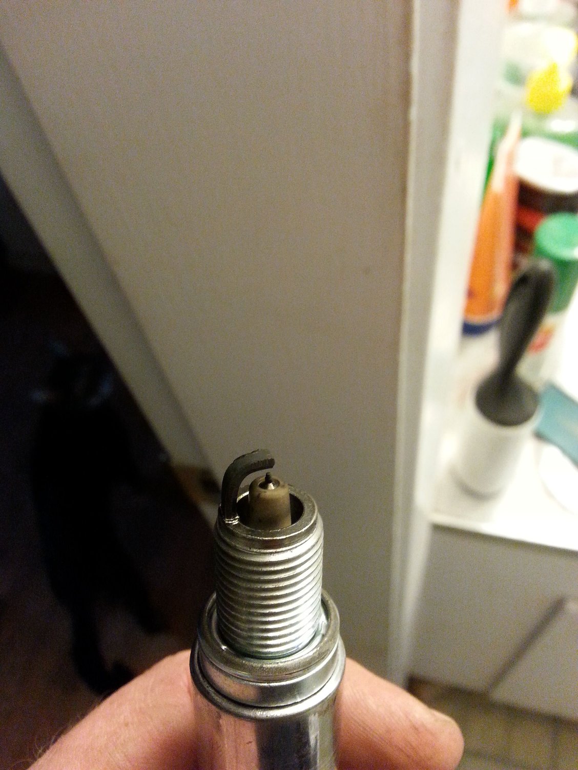

If the plugs are getting fouled with too much fuel they would be wet when you pull one out. If that's the case then starting fluid can't help, that's just more fuel on top of too much already.
Also it looks like the gasket on your plug wasn't squashed. Plug was not installed tight enough.
