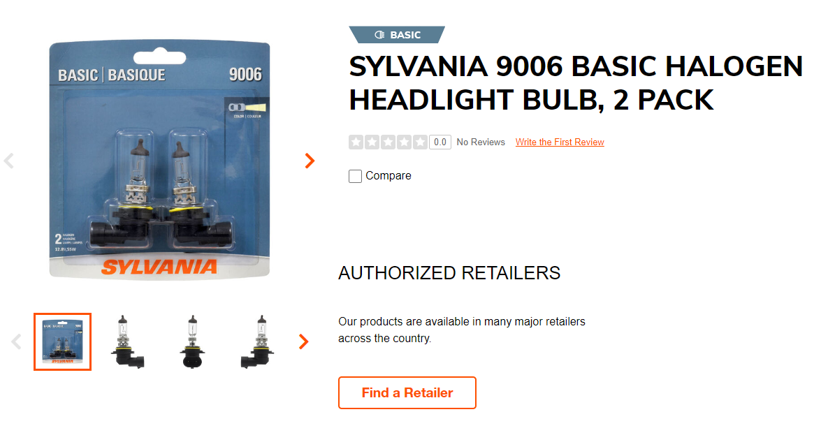

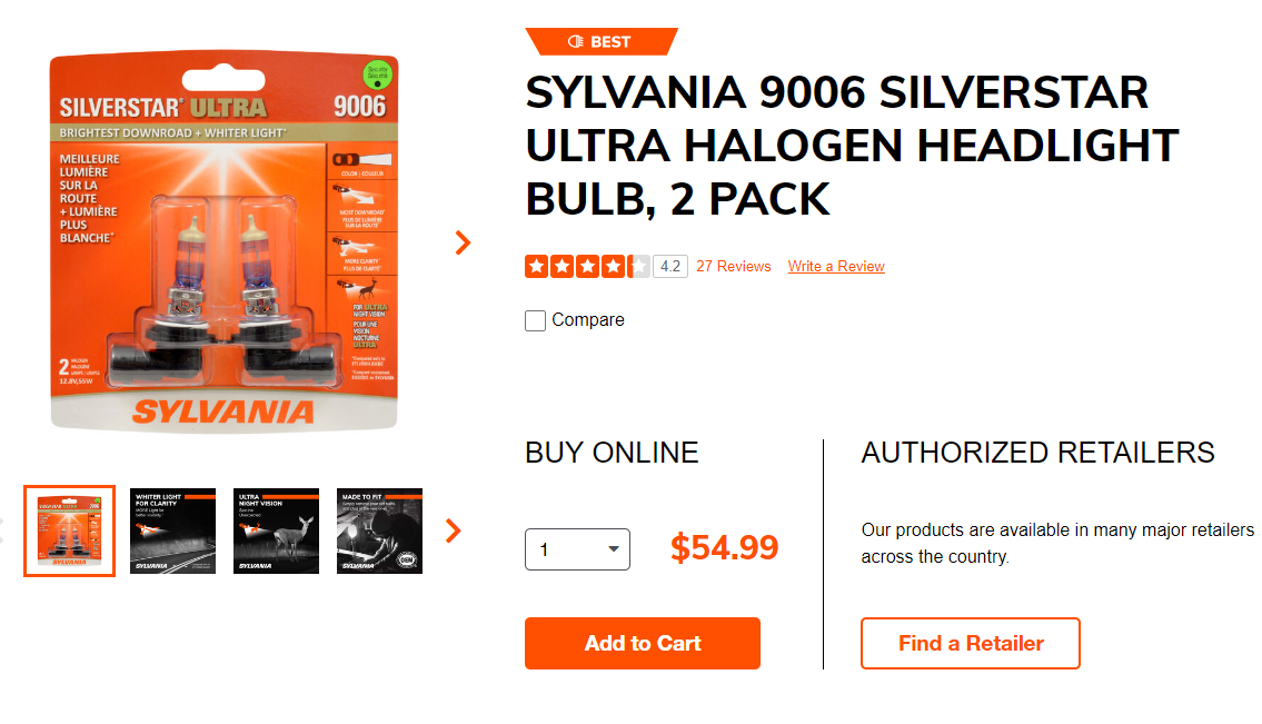

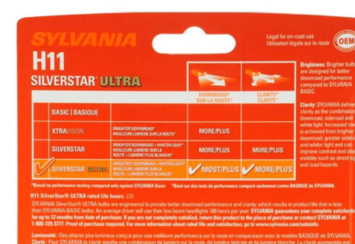

No, I'm talking about the "level" of bulb.
Sylvania basic:
Sylvania Ultra which claims to put more light down road as well as improve clarity.
Back of the Ultra package. Sorry for low res picture, it's what I found online. Note the ~230 hour lifetime rating.

Yeah that is one option. If you just use 9012s they are brighter with the identical beam pattern and a longer lifespan for the bulbs. Best of both worlds 🙂

So then get an Ultra bulb in a 9012...
