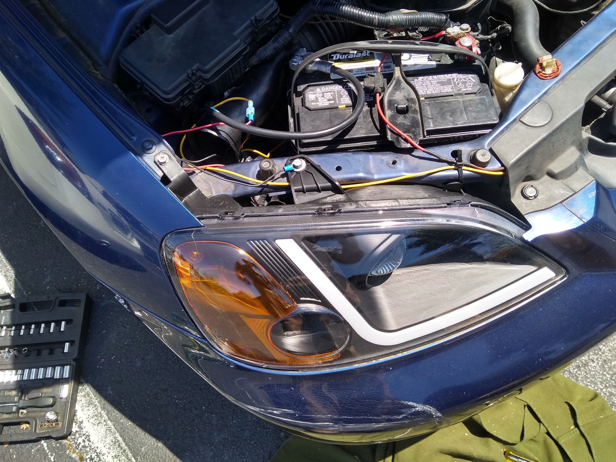

one years ago upgraded headlights (with added DRL, I wired with dedicated fuse and switch, go on/off with ignition), disabled no change

new headlights

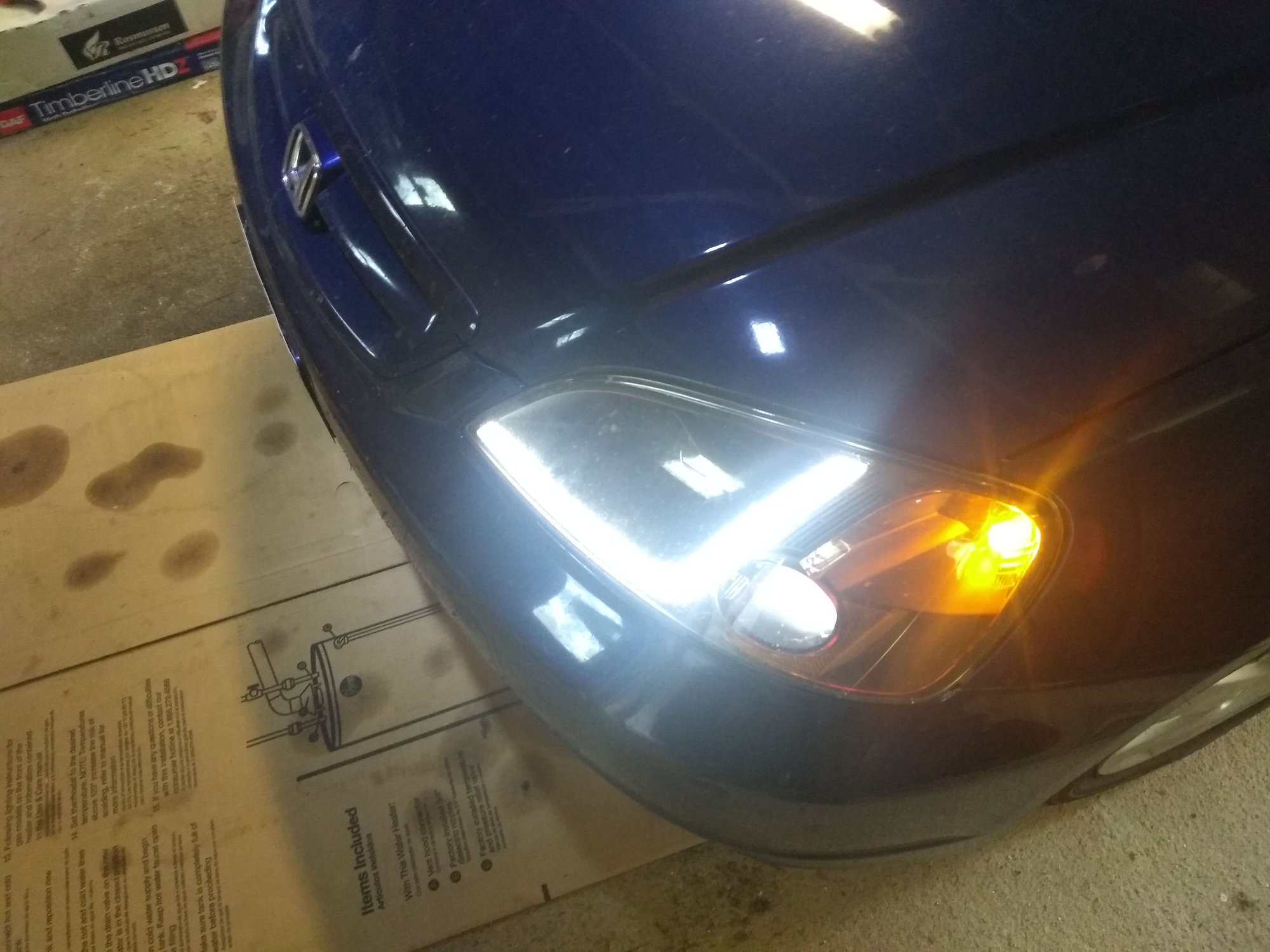

DRL alone, right after install

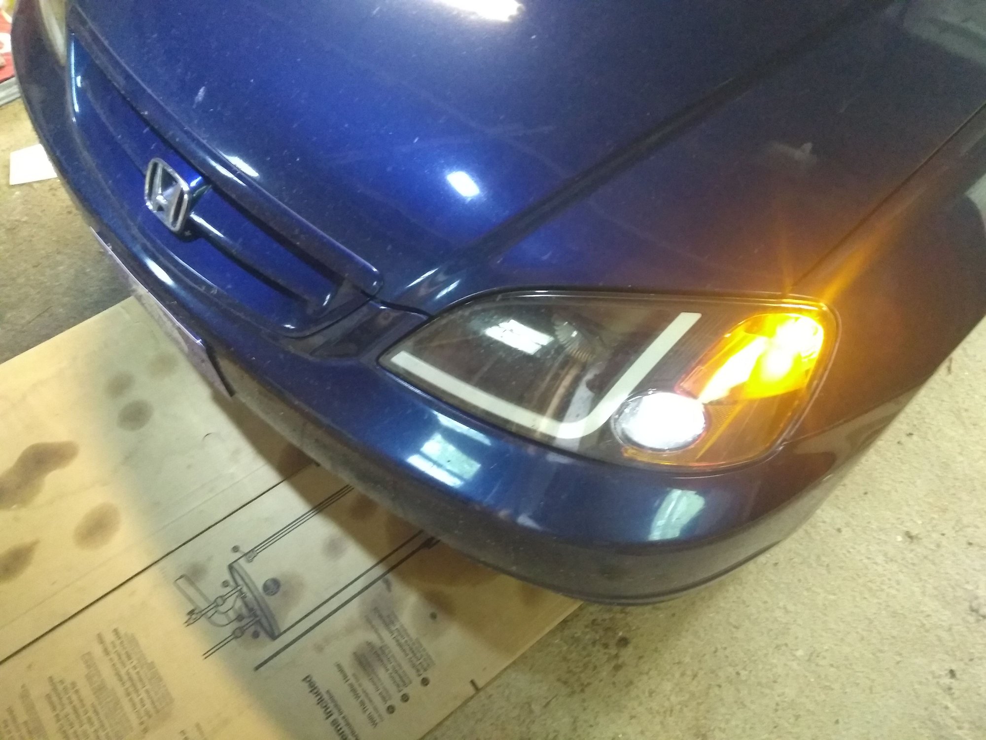

current parking marker lights (always) on, DRL off
both on
