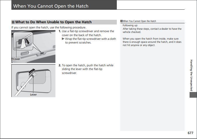

My girlfriend has a 20' Hatch Sport only around 8500mi on it and I just experienced an interesting electrical problem. She had just gotten back from work and was saying that her trunk wasn't opening.I went down to check it out and yeah it wasn't opening with the key fob or the trunk release on the actual hatch It's about 5 in the morning and too dark to tell if there was a button on the interior of the car.
by the way, the button on the key fob just unlocks the hatch, it doesn't pop it open.
