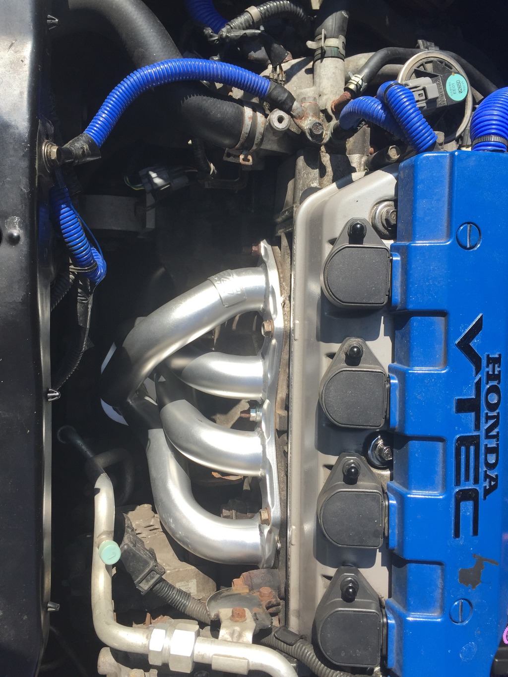

Finally installed my DC Sports 4-2-1 header with O2 defouler. Unfortunately I popped a p0134 so either I jacked up my AF sensor or it's not plugged all the way into the extension harness. I will find out tomorrow.
Also removed my front sway bar the other day, couldn't take the clunking anymore. I must say I enjoy how it handles without it! Thanks for the removal tip, sdaidoji!

hahaha, now if you change the tie rods, we have almost the same work done
glad the twisting the bar worked to pull it out
Good luck on the 4-2-1 - I did not have that problem because i took the 4-1 header
Possibly you might notice a little more mid-range than I did (although I have the AEM CAI + Crower stage 1 cam, so not sure how that is playing into my results)

Lol, already did tie rods! Swapped them to rsx ones to fit my type s front suspension. I'm thinking the sensor might be toast since it was run for about 3 months with a bad hg last year.
I swapped to this from a Chinese no name 4-1 and I really like the smoothness and midrange power.
Ordering a stage 1 tomorrow with my tax return! And a new af sensor too I suppose...

Make sure that is what is wrong. Even with a O2 emulator, you can still get cat codes. It tricks the computer and sometimes it does not work. you might need a longer extension or one with a bend.

Thanks man, I got an adjustable 90 one. Everything I read seems to say that the p0134 is for the upstream sensor though, the defouler is on the downstream.

P0134 is for the upstream sensor.

So I got her jacked up today and found that I apparently hadn't tightened down the defouler and it was loose
Tightened it up and secured it properly, reset my engine light and it's been good so far, about 15 miles anyway but it came back in immediately after reset yesterday so I'm hoping that's all it was, we shall see.
Gave her a quick wash when I was finished.
Also ordered my stage 1 cam from summit racing, supposed to ship direct from crower in about 2 weeks.

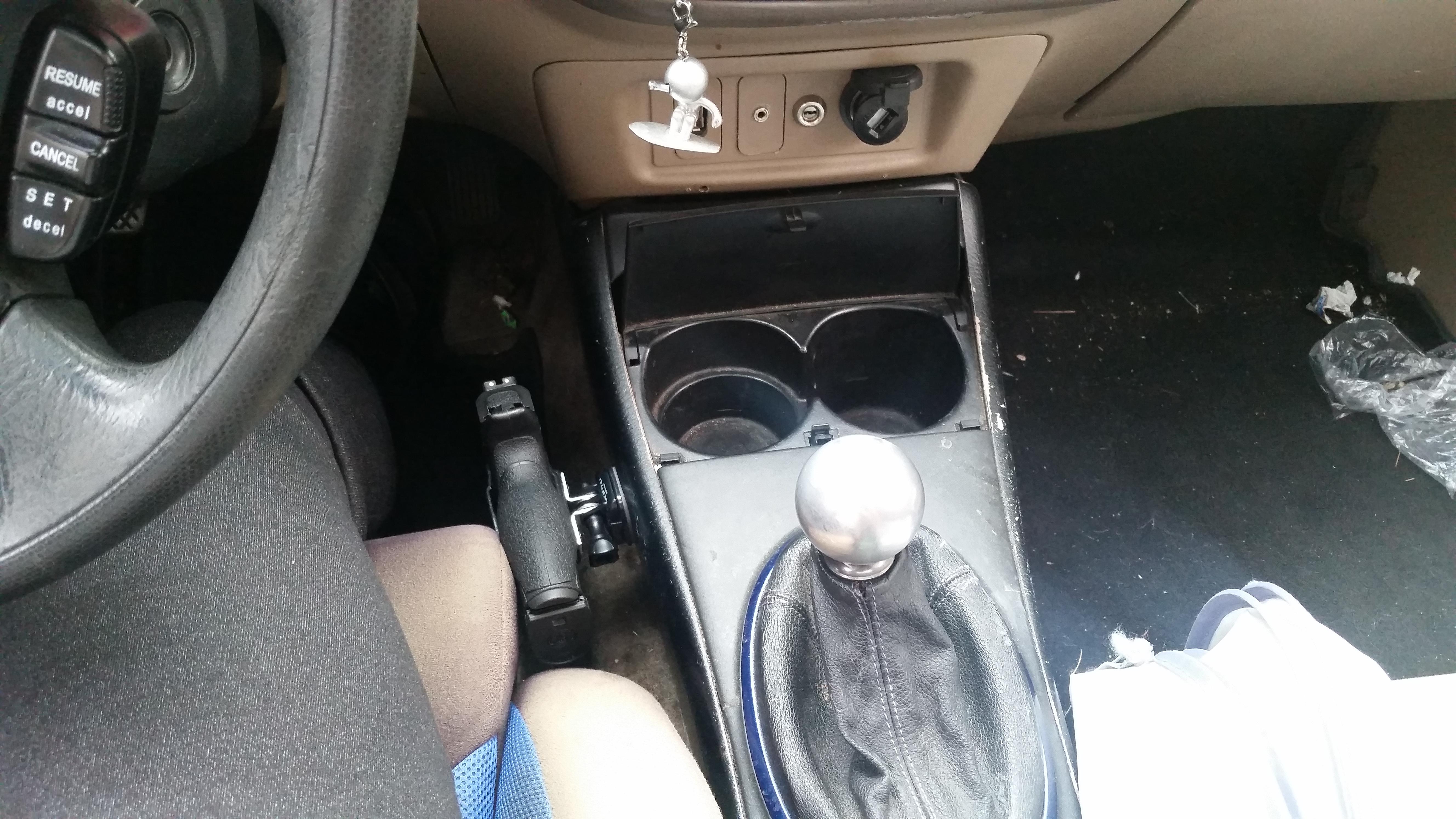

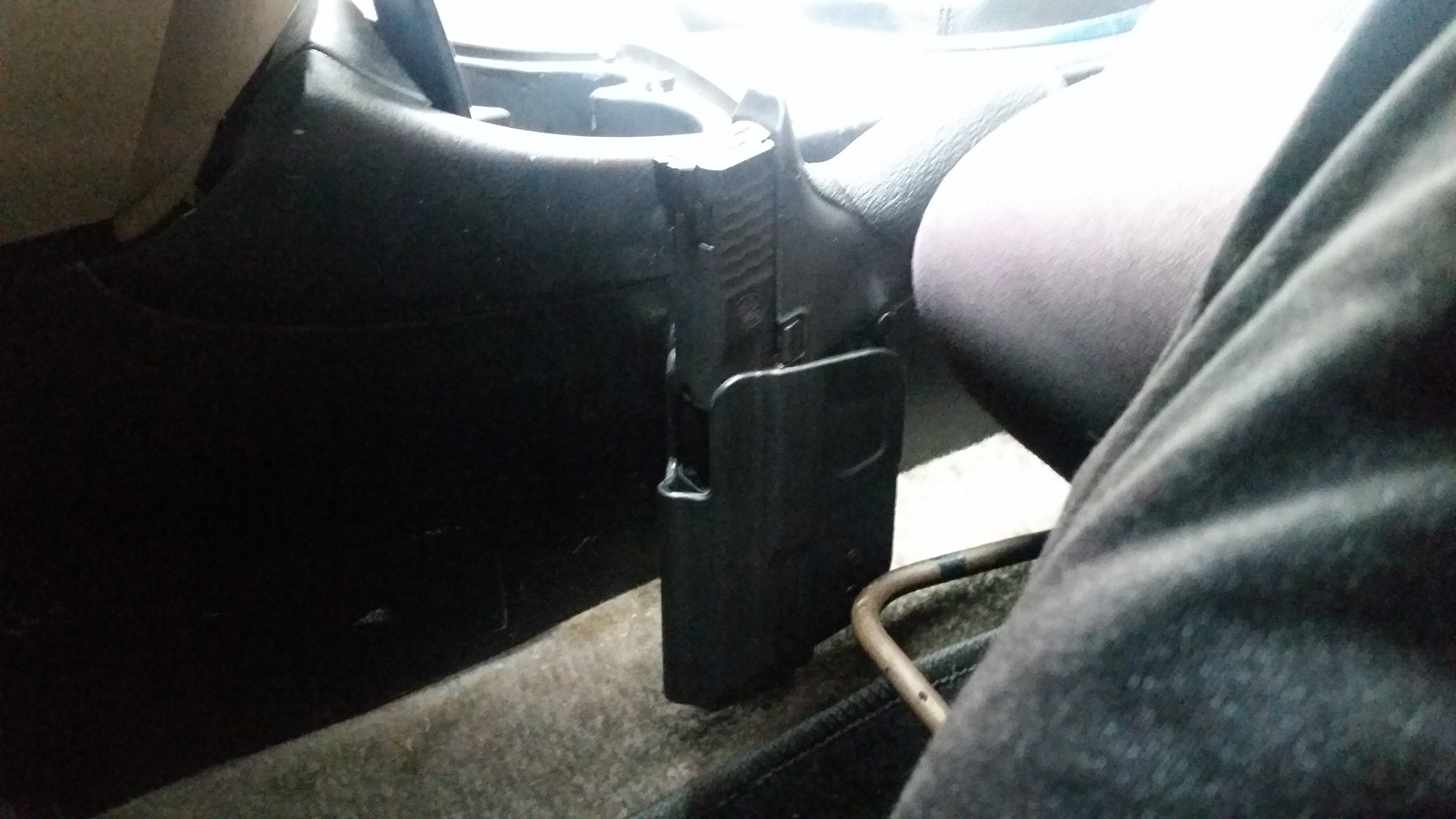

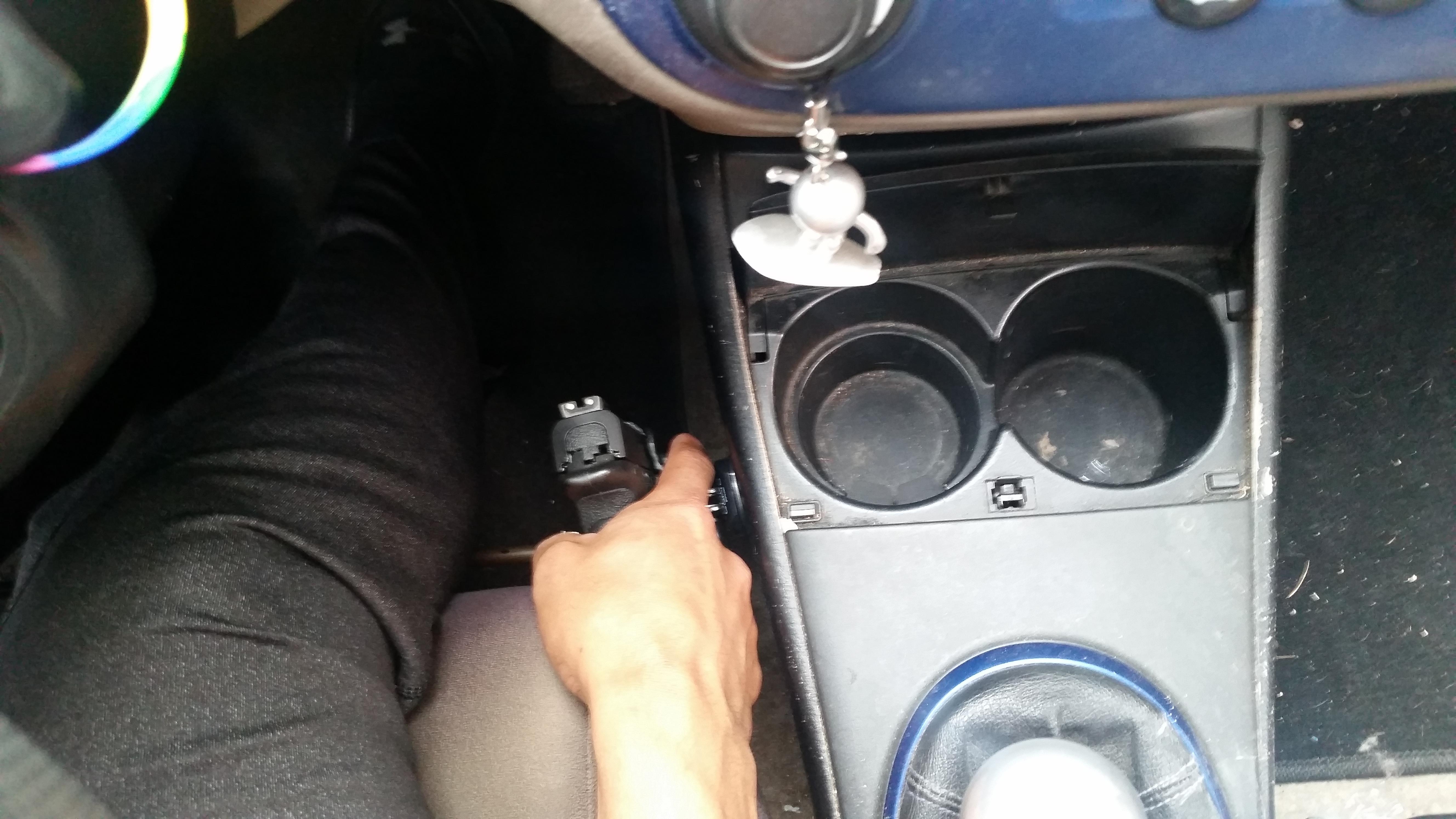

hey man, don't knock 550 paracord. That **** is awesome. That AR15 mount is quite ghetto, though. Effective, yet ghetto
I just took pics, I'll upload here in a bit
edit: PICS!
Dunno why this came out so potato quality, but you get the idea
Top view to show you where I have it. Don't mind the trash on my passenger side
