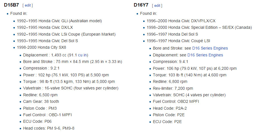

A 98 DX came with a D16y7 non vtec. The D15 is OBD1 and the D16 is OBD2 so I would imagine the ECU needs to be changed.

If you scanned it and the only error to come up was for coolant temp then the ecu is probably functioning fine with the engine. Chances are the engine is running rich because of the coolant temp sensor error though. Could be the issue with the idle.
I also read some info where someone had swapped the head for a d16y8 on that engine and that would probably be your biggest hp gain short of an engine swap or turbo so that might be worth looking into as well. I don't know what sort of racing you aiming to do so not sure how important hp gains are for you either.
