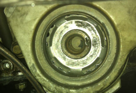

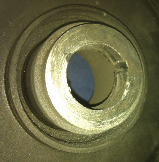

So i took the crank wheel off this evening and had a look at whats going on in there. I recall that when i first loosened the crank bolt that the crank wheel was stuck tight. It wouldn't move. Would it be fair to say that the inside of the crank wheel and the actual crankshaft are supposed to be a snug fit ?
Cause if they're supposed to be tight then thats my problem. When i place the crank wheel on the shaft there's about 1mm of give in either the left or right direction. The crankwheel musn't be centred properly onto the crank shaft ?
I've taken photos of the inside of the crank wheel and also the crank shaft. I tried to take photos of the gap between the wheel and shaft but was unsuccessful.
If the problem is due to the inside of the crank wheel worn out is there anyway of fixing it that doesn't involve ordering a new crank wheel ?

Re: Took my drive belts off and now my engine sounds like there's a hole in the exhau
Well that would explain the wobble at least.
If that pulley has had the hole worn, then correspondingly, the end of the crank where it fits may also be worn.
The key was beat to death from the loose pulley.
This looks like what happens when one runs the engine with the big crank bolt loose (not tight enough = loose).
You might look to see if the keyway for the crank timing gear also has been beat out.
See how well the new crank pulley fits. It should slip on, but have zero play.

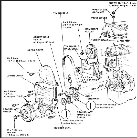

So i've fitted the new harmonic balancer and it fitted very snugly onto the crank shaft. I had a look at the timing belt drive pulley and it also looks fine. The car now sounds absolutely fine. Which is fantastic. Thanks !
The only problem is that the timing belt drive plate was put on the crank wheel after the timing belt drive pulley was put on. So basically i've sandwiched the drive plate between the crank wheel and the timing pulley (instead of sandwiching it between the timing pulley and the engine block).
I got the timing belt replaced 116000 Ks ago which means that my drive plate has been in the wrong place for a pretty long time. But i'm due to do a timing belt change anyways so i'll fix that up when i get back from holidays.
I've read in another thread that its not good for the guide plate to be in the wrong place.
And to top it off i see that there's engine coolant leaking out of the top seal of the radiator. I guess a 16 year old car with 300K plus Ks on it is going to fall apart sooner or later....
Old Oct 22, 2015
I never touched the actual timing belt itself.
EDIT: Co-worker just asked, "What did you do, use freekin magic? Did you teleport the new seal in?" LOL
Um.... even if you didn't replace it, that counts as touching it.
Sounds like you got it assembled wrong, and you NEED to take it apart again to correct it before it destroys the timing belt and gets real expensive.
If smashing the guide plate has caused it to flatten out, it needs replaced.
Pay attention to which way the plate is supposed to face. If it's backwards it can shred the belt.
If the belt has started to shred, it needs replaced.
Don't forget to tighten the big bolt this time!

So I just found this diagram of a 99 civic online on: http://www.carenginediagrams.com/199...e-diagram-268/
Looks like I can stop panicking because there's two plates ?
This diagram of the engine is different to the one that was uploaded to this site on this thread: https://www.civicforums.com/forums/2...t-96-00-a.html In that thread the diagram of the civic engine has only 1 plate ?
Jeez. Now its just getting more confusing... I guess the only way I can be 100% certain that there is 2 plates on the car is to take it apart. The diagram that I've attached to this thread shows only 1 woodruff key where my car appears to have a key for both the crank and timing belt pulleys.
Name:	99 civic engine diagram.JPG
Old Oct 22, 2015
The best way to stop panicking IMO is to figure out for certain what parts are really on your engine.
Your first link above this looked to me like the style of timing components the US had in 1995 and earlier, prior to the introduction of OBD2 (5th gen Civics).
The link to this forum shows an engine version used for early OBD2 (96-00, 6th generation Civics here).
Australian 99 GLi civic. D16Y4 Engine. EK1 model. SOHC.
All my info is for US spec cars, I have no way of getting info for cars in your market.
Can you find an online parts catalog from any Honda dealerships in your market (Australia) ?
Got pictures of your actual timing gear and stuff?
If your crank gear does not have a cast-in belt guide on one side, it will (probably) use 2 stamped guide plates as in your diagram link.
If it has a cast-in guide on one side, it must face the correct direction, and the open side must have a belt guide of some sort.
(I've seen some manufacturers use the harmonic blalancer as a timing belt guide too)
The North American version engine in that year (99) used a crank timing gear with one cast in guide plate that incorporated a set of reluctor teeth for the CKF sensor, which was used for misfire detection. See the shop manual page 6-20 in your link to the DIY post in this forum above for a picture.
I've seen various styles, I couldn't tell you which type is on what engine.
Your timing gear could have a cast-in key instead of separate key.

Old Nov 7, 2015
john1976's Avatar
Joined: Sep 2015
Posts: 17
john1976 is an unknown quantity at this point
Hi Jason16.
turns out that the inside of the crank wheel was chewed up and worn. So when i re attached it it wasn't centred. So that was the noise. I replaced the crank wheel with a new one and it appears to be a lot better. Going to do a timing belt change and i can't find a manual for the Austrlian D16Y4 engine. I rang honda and they said it isn't printed anymore.
