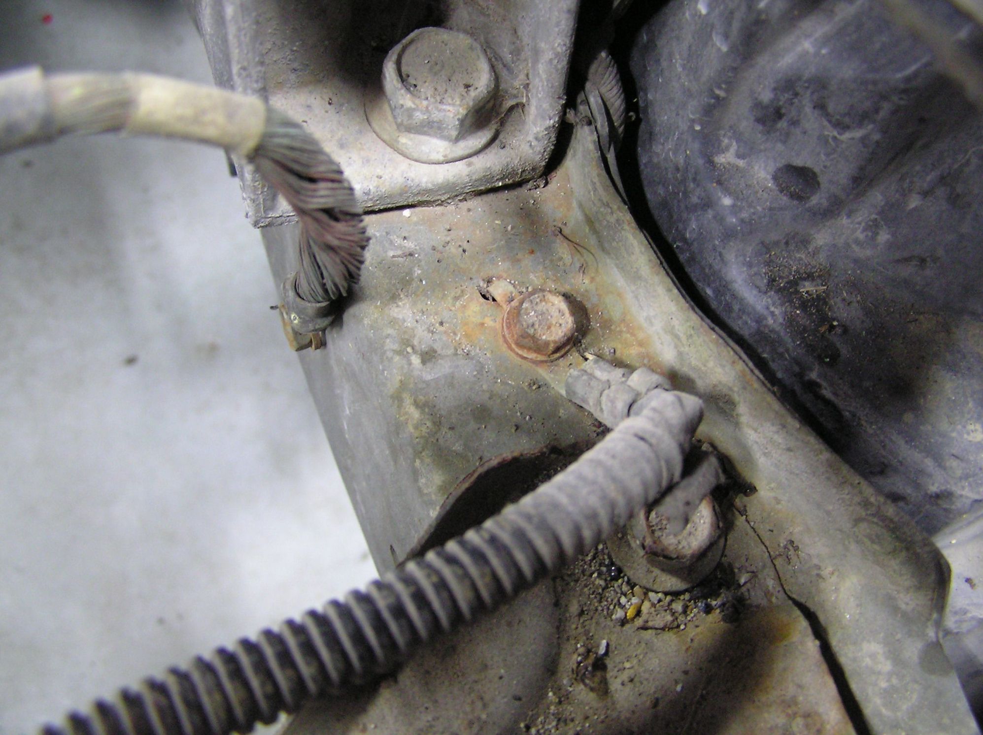

When this happens the car will lose its clock settings and i have to reset it and the radio code
inspected cables and grounds
Neg batt cable attaches to the body....Take that apart, wire wheel it, clean through the paint to bare metal, wire wheel the corrosion off the bolt
I like to smear some silicone grease on the bare metal for protection
The other cable in the pic goes from body to transmission, clean the snot out of that one too, on both ends
If someone installed the cheap battery terminals, the cables are probably corroded too. Good place for bad connections.

Ill blast the grounds tonight when i get home and see how it goes, it was old lady own and sat around so i bet your not far off. my main battery terminals are both factory and very clean so i know they are at least not suspected. heres hoping we can keep this fix simple!

Cleaned the grounds last night, its amazing how honda engineered two 10mm bolts to ground the whole engine, i was surprised at how small they are. cleaned grounds and same problem starting this morning, but now it sounds like the starter solenoid for the SECOND time on a TYE brand starter, cant recommend them. I purchased a used starter with 50k out of a 2011 that ill be installing tonight and hope my problem has been these junky starters. well see if the problem sticks around with a factory part installed.

Soooo now this time it's not losing all power to the dash and locking up the radio? So fixing grounds was an improvement
Yea there have been complaints about short lived starters, and many cheapo aftermarket units can be craptacular.

Time will tell if the clock stops losing function, but the starter is obviously going out again so Im focusing on that. As long as the thing starts every time the clock can read 13oclock for all i care. the clock seemed to go out in conjunction with the car not starting so it was a symption of the problem. i will not be surprised if fixing the grounds up does eliminate the clock problem though, they were fairly corroded.
you could hear the solenoid banging the drive gear off of the flexplate like the last one did before. total junk, Ive heard that about this year range honda starters which is why i assumed so powerfully it was solely a starter issue.
