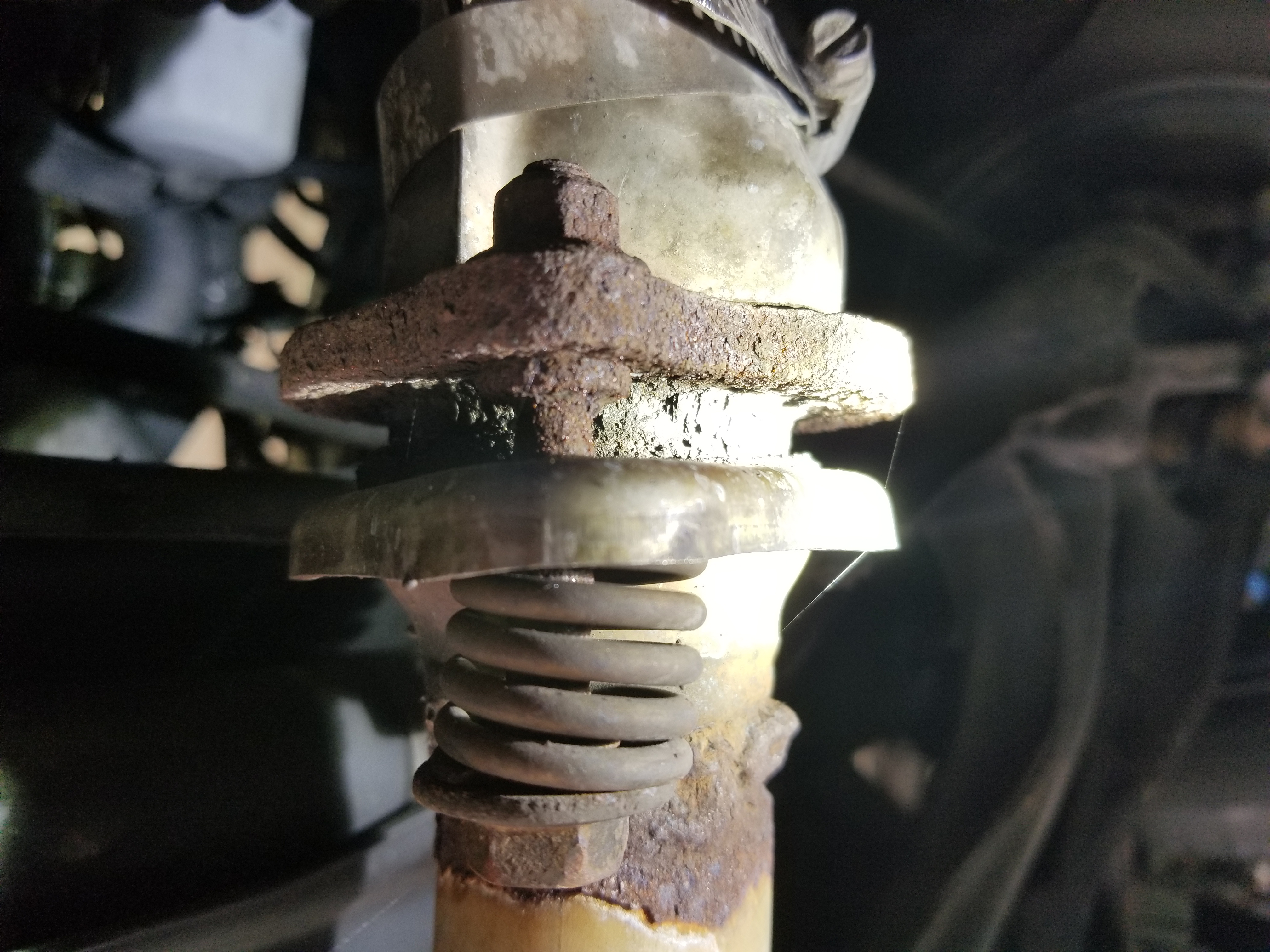

Hi,
I have a 2003 DX Sedan with 241,000 miles on it and while changing the oil today I noticed the oil pan is rusting through in 2 places (not leaking yet, but I can push the spots to make them buckle with little pressure, so only a matter of time). This led to me taking a closer look at the hardware as I came up with a plan to replace it and noticed that all of the heads are swollen with scale, so I'm sure they'll need replacing as well.
I was wondering if anyone had a link for the hardware necessary to replace the oil pan?
Also, if you have a link for the spring bolts holding the exhaust on, I'm sure I'm going to bust those as well seeing as they're just as badly rusted.
Thank you!

Bolts M6 x 1.0 x 18mm, common hardware bin length would probably be 20mm (also, get flat washers for the bolts)
Bolts for spring loaded joint can be had at any dealership parts department, and I expect most parts stores can get an equivalent kit with bolts and springs

I was able to find the bolts here, but the spring bolts you linked are for a Toyota so I went with these instead. Even so, your reply was extremely helpful in getting me there, so thank you.

I also picked up a flange repair clamp in the (very likely) event the converter's flange doesn't survive disassembly. The weird part is that everything underneath this car is either really badly corroded, or completely rust free. There's seemingly no in between.

Well, the job is finished. It was a little easier than I anticipated, the spring bolts came out intact and without damaging the manifold flange, but having a new set was a good idea because they weren't going to last much longer, if even survive the reinstall, and everything else was pretty straight forward. I ended up needing nuts, but was able to save the studs. Turns out there's 10 stud/nut fasteners on my pan, and 8 screws. I replaced 4 screws and 4 nuts, but was able to reuse the rest of the hardware.
