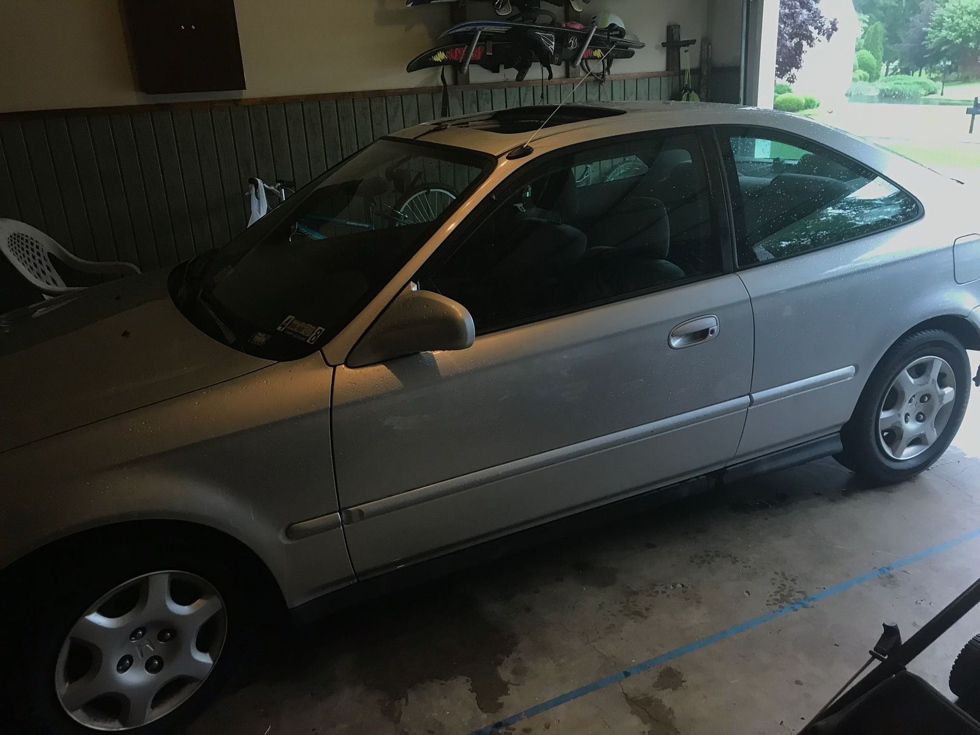

Greetings all. Just wanted to post a quick hello as I recently acquired a 2000 civic as a first car for my son. In my youth I owned a few CRXs, so figured with the cheapness and availability of parts that a civic would suit him well. The car is a 2 owner MT ex w/150k orig unmolested miles. So far weve swapped out the faded headlights with new eBay ones and performed all the maintenance items including fluids, belts, hoses, pads, thermostat, Water pump, timing belt, plugs, wires, etc. with OEM. Most recently we picked up a set of xxr 15 wheels w/ tires off of CL. Now going through the gaskets, seals and vacuum lines to replace those. I picked up a replacement steering wheel from local junk yard for $20 thats in great shape to replace the chewed up rubber one currently in the car. Interior is perfect other than the crappy door panels and drivers window reg. Searching for a drivers door panel now. The clutch seems great and am a fan of the d16 engine. Ideally Id love to find an engine off CL or locally off forums to build in the garage as a project. Here as pictures as she sits now. If there is anything else you think should get addressed let me know.

Welcome! Car looks super clean
