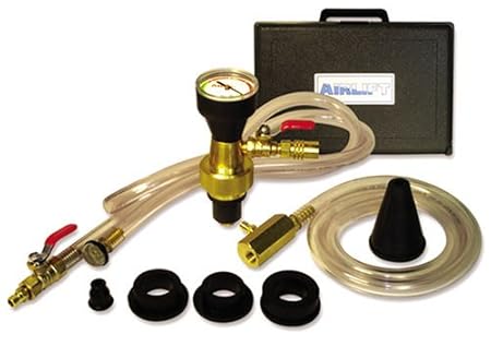

Any tips for swapping coolant in the 7th-gens? I know basically how to do it (I'd BETTER know at least that much); am more interested in possible snags to avoid, and tips to reduce mess/time/regret. Have gotten away with just some coolant consumption with this D17... I'd rather not give it an excuse to overheat and ruin my year.
Does this motor fill with coolant better when the front end is elevated, filled through both the top hose and the rad filler neck? Or does the car-level/fill-rad/idle-&-blip-until-rad-level-drops-and-stabilizes/top-off, work just fine? If it fills better elevated... great, as I plan to do trans fluid at the same time. Plan of course to fill with only Type 2...

So is an Airlift
I get a lot more mileage from the funnel though, set it on, fill, run, walk away and do something else for a while. Little or no babysitting.
Airlift is rarely used.
