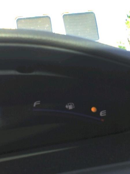

Re: 2007 Civic Coupe Auto EX Gas Mileage Decline!!??
Ok guys, I did what most people would recommend by keeping it below 3k rpm and i got the car to shift mostly at 2.5k. I pumped on 9/28 and just pumped today 10/7. On 9/28(Sunday) i pumped 10.33 gal when i had 1 bar left with the light on and today(10/7) i pumped 10.44gal with no bars left :X. I calculated and i only got 30mpg or 30.5559 etc if you want to get complicated. I mostly go to school and on average i travel 30miles a day or sometimes 40 depending if i have errands or not. So... what do you guys think? Is this bad or bad... ii read on some other forum that our tanks carry 13.2 gal? true or not? I pumped today with no bars left and light on and did NOT top off and let the pump stop on its own at 10.44 gal (FULL) So my tank lasted me 1week and 2 days traveling everyday.
