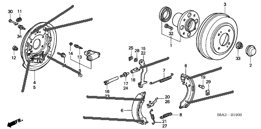

OK, I thought it was a long a tough job, but I tried fixing it and it only took me less than 30min... and the squeaking's gone
you'll need...
--multi purpose grease
--Paper Towels
--flat head screw driver
--2X M8 bolt
--socket wrench 8MM... I can't remember
--long tip pliers
--painters brush
--7MM wrench
UNASSEMBLE
--use the M8 bolt to take the drum off #3 (make sure the ebrake is disengage i made a mistake, i forgot to disengage the ebrake and lucky I didn't break anything
--do not press the brake pedal when the brake drum's out, the self adjust will keep adjusting itself that you'll have to reajust them again to where it will not hit the drum, when you're done greasing up... so don't press it, i'm dumb so don't be like me
--look at the shoes very carefully to where there's metal to metal contact, that's where you put the grease...
--clean the drums using the brush... i prefer wiping it with a damp paper towel
--take the bottom spring from the brake shoes #8 using the flat head screw driver
--take spring #21 off using the long tip pliers
--take the brake shoe clamp off push the clamp in and twist the metal using the long tip pliers
--you don't have to disassemble the top spring #7 just move it to where there's enought space to put grease on the side metal on the brake shoes to where it hits the back plate #4
--I made a mistake of trying to take the #7 spring out, but that was unnecessary knowing the the shoes are still about 80% pad left, and i'm only greasing up the contact point and not changing the shoes...
--If you happen to pop the cylinder cap, don't panic you'll be fine
--clean, brush the back plate with a brush, then follow it with a damp cloth
--let it dry off, and put a dab of grease on all contact point I put some lines on the picture above, but when you see the brake assembly, you'll know where the contact points are...
ASSEMBLE
--make sure you put grease on all contact points
--if you did popped the cylinder cap, put them back properly with all the rubbers tucked in
--put the spring #8 using the long tip pliers, by placing the pliers straight up and down on the hook of the spring it will go in easy, I did it with one try
--put the shoe clamp #29 back
--put lever adjuster back
--the the spring #21
--make sure the brake pads are back to its proper place
--wipe all excess grease or fluid spillage
--put brake drum back, give it a little spin, make sure it doesn't wabble, and or hits the pads... you can tell if it's not even, because when you turn the drum it makes a wabbling motion, or it hits the shoes
--bleed the brake line i did 5x 3 pumps a set, if the cap is not in properly there would be no to little fluid coming in the hose and you'll see fluid dripping from the drum
--put tires back and drive off slowy and start braking every 20-30yards
--if you spilled brake fluid like I did get a hose and spray some water on the fluid to get them off, they are highly corrosive so a little spray will get that off the metal...
and that should take care of the noise...

Drums have no indicator strips. You either have lining, or you don't. So you need to open them and check them. If they're squeaking without hitting the brakes, I'd look into something with the wheel bearing.... maybe you got some **** in there, or you may have some piece of **** stuck somewhere that rubs a rotating part. Drums get dirty. Vaccum them out and see if you find something.

to clear this up Drum brakes DONT have wear indicators on them !!! And as far as the noise , more than likely its caused from dry contact points where the brake shoe rides on the backing plate. Each brake shoe should have 3 contact points that may need lubricant(a heavy grease, some people use anti-seeze). Also if the brakes are severly out of adjustment the shoe will travel to a spot on the backing plate that may not have lubricant on it and generate noise.
Remedy: clean brakes with brake clean, and lube the contact points and properly adjust the brakes!!

At work we use a silicone based lube, but ive seen everything from wheel bearing grease to anti-seeze . Pretty much any grease will work, it only takes a small dab at each contack point.

going light footed on braking doesnt wear it down faster, what it does is causes heat with little force on the rotor so instead of wearing it down it glazes it over giving it a shiny coat and thus making any future braking harder because with this new smooth shiny surface the pads must knock that out before they can really grip again, you can pretty much sand it off but takes a while and you should know what your doing,
also if you are doing it yourself get familiar with the style of brakes in the rear by looking online,
i think civics use dual servo drums(correct me if im wrong) and all that means is that the shoes (not pads, drums use shoes) are stationary where as on a single servo drum when the brakes are applied the whole unit kinda shifts down applying more force to the leading shoe.... i think this is more for rwd or heavy cars.
just get familiar with the procedure for what to take off first and youll need to get the tools to remove the return springs and everything plus youll want to learn how to adjust the self-adjuster once everything is back on, (if you barely ever use reverse the adjuster should definately be adjusted because it only turns itself when you brake in reverse, otherwise you might get away with not turning it.

go to autozone or w/e and ask for the smallest amount of high temp brake and bearing grease.
im not very sure but i think that the rears on our cars are non-serviceable bearings
