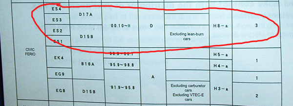

ok.. found my install manual...
it goes as follows...
Car name - car model - engine model - manufacturing year - ecu position - remarks - terminal drawing - vtec number - and sensor type
you cant see.. but the sensor type is PR-6
since the em2 has the same d17a as the ferio... it works either way

Interesting. Mine doesn't come with that, but it has a table with the rpm ranges or something. 1=high range 3K-7K, 2=midrange 3K-6K, 3=low range 2K-6K.
So I guess vtec=3 then. I'll go change it. Maybe I didn't notice anything wrong because my car isn't tuned yet.
