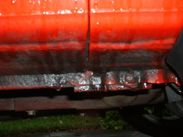

guys tell me if i'm right; it's this thing right??

Yeah, but if you're putting your car on jack stands, you can't jack up the car in the location shown on the pic, since that's where the jack stands would go. There are other places to do it and I just want to check if where I did it was the safe one.
