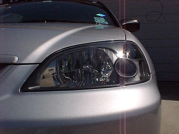

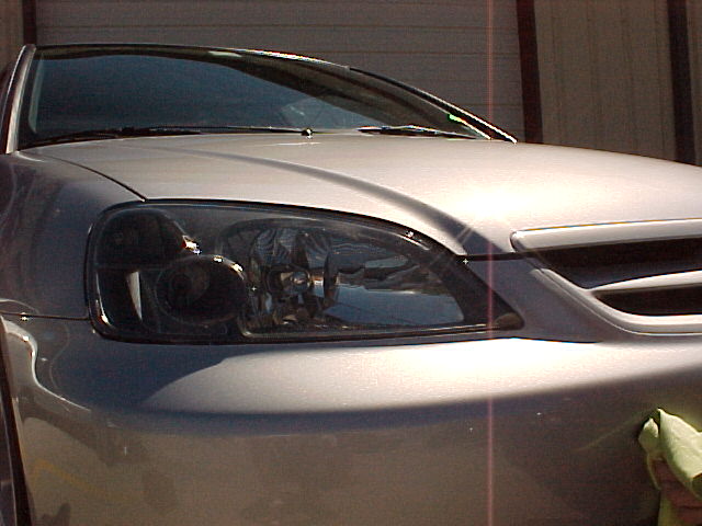

From: Houston
If you want you can also paint them and they look like mine

Old Jan 7, 2004

sorry about the poor image quality
