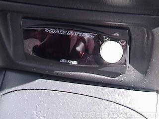

there was that post about the cig outlet or whatever and it showed a pic of the vafc2 in that spot? who made that? i love it. how did u make it? and did u relocate your cig lighter?

was it in a holder made out of carbon fiber or was it just in that spot you are talking about?

yeah....all custom built
hwoody77 has it

just order a panel for $10 bux and dremel the suckah
i ordered one just now and i'm doing the same thing

You'll find out real quick that stuff doesn't like to be dremeled. I tried that with my gauge panel and got no where fast. It strings up, melts and jams the cutting disc. I recommend a razor saw (hobby store), it fits in an exacto knife handle. Its a little slower, but will come out cleaner and easier than the dremel. Unless you wanna rough it out with a dremel and then finish it off with a file or something... the dremel makes a mess.
