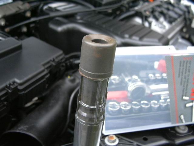

FYI

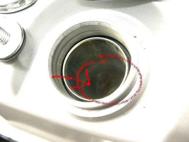

FYI again

it's water that getting in or has gotten in. living in colder temps will cause this in most cases..

I have Denso IK20. On Sunday I checked the sparkplugs and found that I have the same problem. The 3rd sleeve from the left to right, standing in front of the car looking towards engine, had lost of rust dust. I checked in there and there is some rust forming in there.

damn..
i just checked...
it's not only only the leftmost....it's on all 4 of em..
anyway,
i just bough one set (4) of NGK iridium IX..
i bought one tube of anti-seize....which definitely important..
and i also bough one tube of "DIELECTRIC" for the ceramic part of the plug..
do you guys think i need to use this Dielectric thing?
it says that i've to use it on the ceramic part and the cable.....which is on the hole of the tubular thingie (my first pic)
whadday think?
