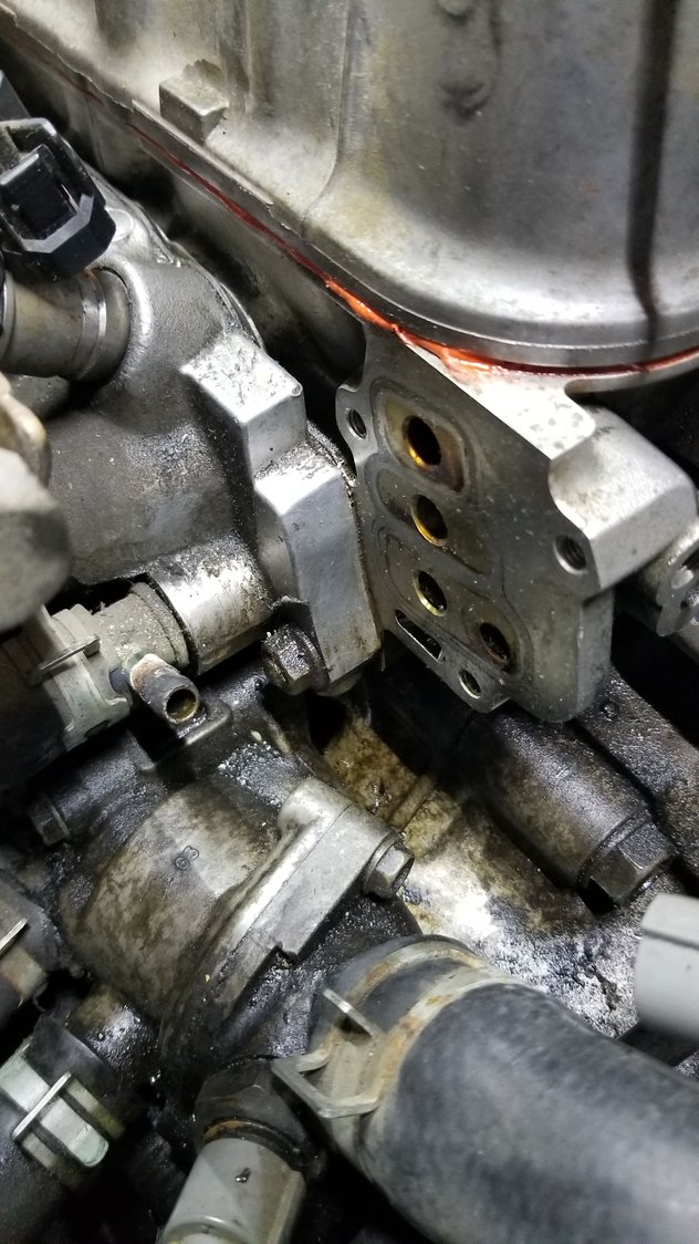

Pls help!!!!! Oil coming from this part that i dont know.
I saw a good amount of oil.leak coming from the side of my engine and coming from this part that i dont know. Anybody tell me so i know what exact part i will buy. Thanks you! My car is a 1998 Honda civic EX. This is the parts.
This is where i took it from. On the intake manifold side of the engine.

VTEC solenoid. Needs the two rubber gaskets.
The first one with 3 sections and screen in your picture
is Honda Part # 15825-P2M-005
This gasket for the top section:
GASKET, SOLENOID BASE (Your dealership can't find this, you have to tell them this part number to get it)
Honda Part# : 36172-P08-015
Hope you didn't lose any of the pieces when you pulled that top off.

Thanks i really apprecuate the help. I bought the car used i just found out the gasket silenoid base is gone. Thats probably why it is leaking.

You have the valve all the way off and apart, replace both gaskets!
