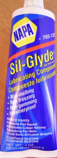

Old 11-09-2005
ctx66's Avatar
Join Date: Aug 2003
Posts: 935
Received 0 Likes on 0 Posts
Rep Power: 261
ctx66 will become famous soon enoughctx66 will become famous soon enough
heres what i use

Old 12-14-2005
fiatdale's Avatar
Join Date: Oct 2005
Location: Cazenovia, NY
Age: 41
Posts: 675
Rep Power: 231
fiatdale will become famous soon enoughfiatdale will become famous soon enough
I use the Napa stuff. works well and cheap.
