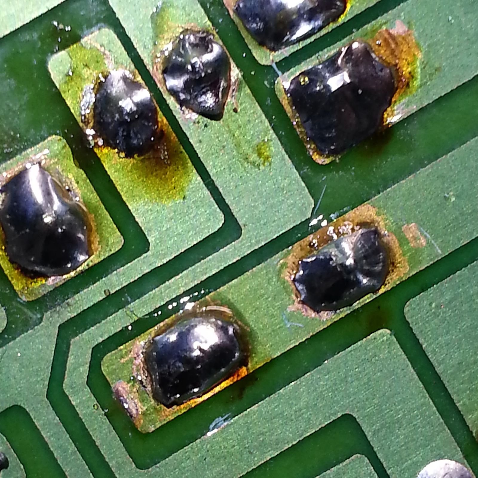

I first got the driver door to open and lock (nephew used to get in through the passenger door with a pair of vise grips), get the hood open (car wouldn't start and release cable was stuck), repaired the rust damage around the rear wheel wells and got the DRL to work again (I resoldered the relay PCBs and removed the jerry-rigged High Beam wire that had been installed as a fix), brakes were replaced (drilled rotors are a stupid idea in the salt belt) and parking brake were stuck (purged years of crud accumulated in the cable sleeves), and made the headlights work decently again (removed the yellow oxidation with an abrasive), fixing the clear coat issue on the roof (I sanded and repainted it), among other things.

Here's a couple of pictures for now showing my version of the DRL Relay Resolder Fix, basically I increased the size of the solder pads to give better support to the relays and so, minimize the strain on the pads and, using lead-based solder, hopefully permanently resolve the issue
2004 Honda Civic DRL Relay before repair - showing relay solder pads cracks and some of the pads being scratched to increase solder size
2004 Honda Civic DRL Relay after Increasing the Relay Solder Pad Size and Resoldering Them with lead based solder (cracks in solder joints are usually caused by manufacturers switching to low lead alloys due to environmental regulations)
