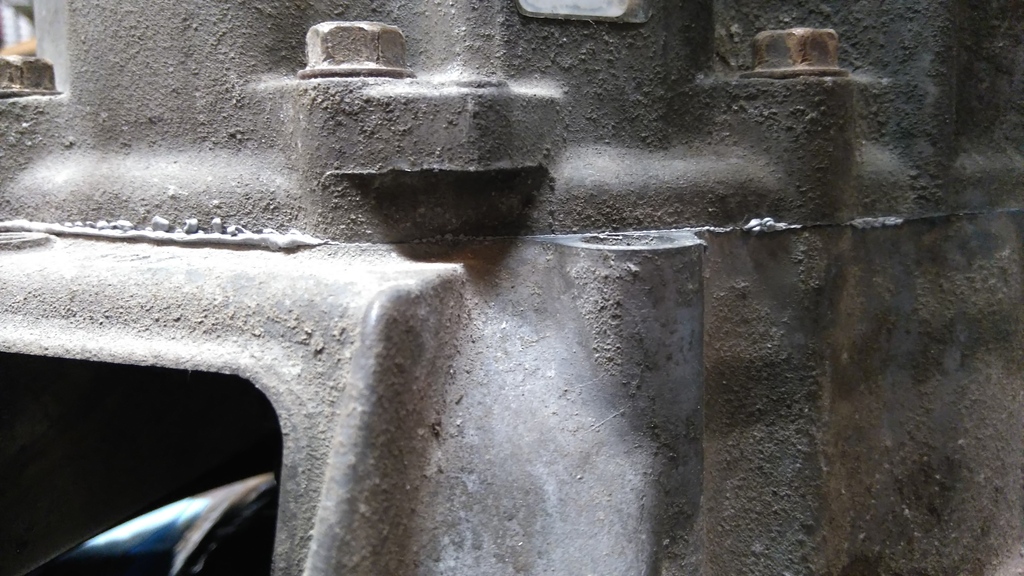

I just replaced my input shaft bearing and am reassembling the transmission. I applied what I thought was an even bead of RTV (Permatex Ultra Grey) to the clean mating surface of the clutch half of the case, along the inside of the surface and around all the bolt holes. I got the other side back on, finger tightened the bolts, and then, as the Permatex package directs, waited an hour before torquing the bolts down.
A little while after I torqued the bolts down (criss-cross pattern according to service manual), I noticed this squeeze out in a few places (example on left side of picture). It looks to me like the even bead at the bottom is from when I initially finger tightened the bolts, and then the "broken line" pattern above it would have squeezed out of the partially cured RTV.
I also noticed a couple of places where there's no visible squeeze-out on the outside of the case, as you can see in the middle and towards the right side of the photo.
So, before I put the transmission back into the car and put everything back together, can anyone offer thoughts on whether this is OK and likely to have sealed properly?
Oh no no no no no.
You assemble and torque this as soon as it goes together. You DO NOT WAIT.
You do not want sealant to cure/harden before torquing, and that sounds like what happened.

I assemble immediately because I want the RTV to adhere to both of the mating surfaces. If you let the RTV "skin over" before assembly it doesn't adhere uniformly to the second surface, and may leak.
Squeezing them together just squishes out the excess, there is still plenty enough sealant left between the surfaces to seal.
