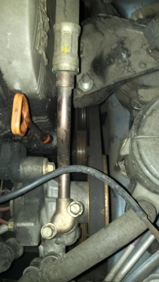

You guys are going to laugh, or facepalm, but I changed the tstat tonight, which btw it was bad. But what is worse is I was looking around and discovered a belt is gone... take a look: Name:  jpg.jpg
Old 02-29-2012
Stock 99's Avatar
Join Date: Dec 2010
Posts: 1,582
Received 4 Likes on 3 Posts
Rep Power: 179
Re: 98 civic lx... overheat, smoking, foamy/soupy coolant
Meh, looks like your A/C belt. You didn't really need that anyway. LOL
