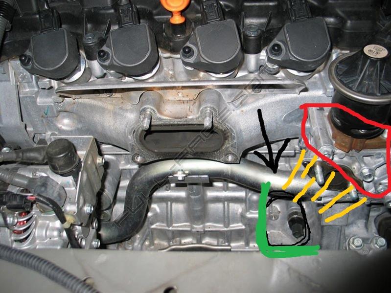

is it normal for a car to act normaly even after removing egr valve wiring plug ,?? for diagnosing a noise i did this ,, nothing happened after plugging it out ,, any thoughts ?? acc to me egr is making buzzing air leaking noise ,,
the guy with a green dot ,,

It's possible there could be a vacuum leak originating in that area, as there is a passage to the intake manifold at the EGR valve and it goes through that thermostat housing/radiator hose casting. The gasket under the EGR valve could be leaking, and it could leak vacuum or exhaust since both run to the ports under the valve.
Get a smaller hose, like a vacuum tube or 6mm fuel hose (instead of that large tube that looked like a garden hose).
Listen around with that, go around the edges of the EGR valve base where it's bolted down.
Here's 3 views of the EGR housing I found with a google image search. Crappy small pics, all I could get are from ebay
One trick is to temporarily seal off the holes under the EGR just as a test. Unbolt the valve, lift it up, get a piece of thin cardboard (like cut from a shirt box or a cereal box) cut large enough to cover the area where the normal gasket sits, big enough to cover both of the working holes. Reinstall the valve to just tight enough to squash the cardboard in place and block both passages. Leave wires unplugged so the valve cannot operate. Test run to see if the leakage or noise is gone.
A new EGR gasket should be cheap.
HTH

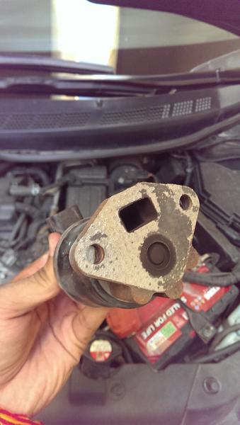

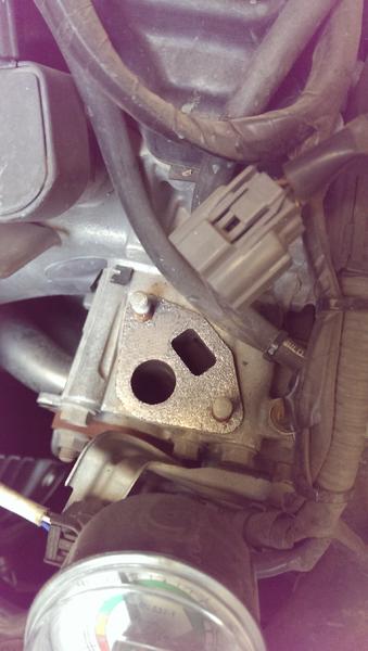

Do tgese pics seems normal ???
ID:	86977   Click image for larger version

Sorry been a long time ...
Yes those look like what I would expect to see if I removed the EGR valve.
I'd get it a new gasket.

well intake manifold is at the back of the engine block ,, but the sound is coming from the driver side where there is exhaust manifold at left hnd egr on top and radiator on the front ,, ... thats my concern here , thats y i m confused if its in intake manifold ,,
there is a l shaped plate which is placed to secure the oil pressure sender unit ,, the noise reflects from there ,, when i used a small hose then it was the only origin of the noise ,, thats y i previously asked yu if its that unit or smethng else ,, try to hear the noise again using headphones ,, i m sure yu will get some clue ,, it comes on low rpm and goes when i press the gas paddle ,, and returns when release it ,, comes at 800 - 1100 rpm ,,,
yu said it is the noise from pulley parts ,, i tested them with no belts on ,,, the noise was still there ,,
this noise never appears at the cold start ,, it comes after reviing engine for lyk 5 minutes or longer ,,
in the morning the engine sounds sweet ,, lyk its brand new ,, things get worse when i return home from college at noon ,,
machenincs here are dumb@$$ ,, they dont know much ,, all they said was its EGR ,, how the hell would a EGR valve make such noise at idle when its not even active ..
its not tranny m sure because there is no noise while driving or relasing or engaging the clutch paddle ,,,
radiator ,, noo , cnt find such clue that it could b radiator,,
whats last left is what yu just told ,, passage/port under EGR valve,,
nd thanx any way for ur efforts ,, yu are helping me a lot ,,
here is the figure below ,,, red part is what u mean as a port./ passage ryt ??
and green is the L shaped plate ( bcoz its not in the figure ) and yellow are the sound waves from red part ( the passage ) and i m hearing that noise in the black marked area ,, it may soubd stupid but this is ol i can imagine ..
Ok there IS the passage between the EGR valve and the intake manifold, it goes through the aluminum piece the EGR valve is bolted to (secured with 3 horizontal bolts), through the cylinder head and ends inside the intake manifold. Use your listening tube, angle it toward the bottom of that aluminum piece instead of aiming at the oil pressure switch. LIsten around the top of this piece too.
Between this piece and the cylinder head.
Picture again of the aluminum piece the EGR is bolted on, showing the side that mates against the cylinder head:
You can see 3 bolt holes, one dark hole should be the passage to the intake manifold, and the last hole should be for antifreeze.
Since there are antifreeze passages that go through the same gasket too, if you really had a vacuum leak there I would almost expect to be noticing coolant leakage too.
The original gasket is metal, I myself have not seen any problems with this.
Idea:
COULD the noise have anything to do with your natural gas conversion?
Does running on gasoline only cause the engine to make the noise?
Does running on natural gas only cause the engine to make the noise?
ANy difference?
Idea:
With the engine running, remove the oil fill cap and notice if the noise changes or goes away. (engine will expel oil out of the hole so just open the cap just enough to vent any pressure or vacuum from the inside of the engine while it is running)
Again, if this noise you are hearing is not causing a problem, it might not be any problem.
