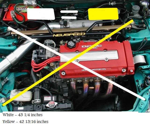

So upon searching around, i came across a thread from this site that explained how to check for front end straightness, read Can I fix it?
from this i did my own measurements, my car is off by about 1/2 inch. Think i can straighten it myself?
Although like i said the radiator support bracket is pushed in Almost exact to the cross measurements, i'm a little baffled?! >(
